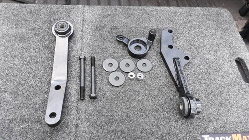

Posts: 9322
Re: Tech Thread - Toyota Hilux...D4D and all older models.
Postby *KRONIK* » November 27th, 2019, 7:33 am
Guys
Front diff relocation kits available
30mm drop
2000 a kit
2500 installed (by appointment only)
708-0101
