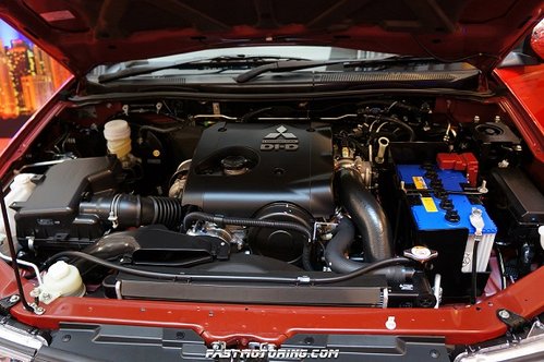

Hi all,
I'm very new to this forum and I own a 4-5 month old brand new Triton VGT 2014 model. I'm from Malaysia by the way. The reason I decided to start a new thread is because searching through forums and Google didn't seem of much help .
I hope the title is quite clear about the condition of my Triton. I'm new to pickups and therefore am wondering if it's just me being sensitive or the Triton is not supposed to have a whirring/Grinding/rattle/buzzing noise when I decelerate and quickly reaccelerate back. The noise happens just for a short while and even the SC couldn't determine what it was. They've ruled out that it's an scv issue. I do feel like fc has increased ever since i noticed this which is after the first service of 1000kms. However, the noise does not repeat consistently. Sometimes i can recreate the sound but sometimes it doesn't happen.
Is this normal? What should I look out for to tell the SC?
THANKS for all of your time and advice

Toyopet

Postby Toyopet » June 20th, 2015, 9:19 pm
Welcome Dark_Angel85. You've made a wise choice in choosing a Mitsu Triton. I can definitely hear some weird noises in those videos. I sounds like its underwater but I hear a grumble. That's a strange noise that I've never heard before. Check the air and fuel filters, all belts including the belts inside the engine cover, all mounts and exhaust for leaks. That's definitely a strange one.

Re: TECH Thread - MITSUBISHI L200, Sportero, Triton.
Postby Dark_Angel85 » June 20th, 2015, 11:09 pm
Toyopet wrote:Welcome Dark_Angel85. You've made a wise choice in choosing a Mitsu Triton. I can definitely hear some weird noises in those videos. I sounds like its underwater but I hear a grumble. That's a strange noise that I've never heard before. Check the air and fuel filters, all belts including the belts inside the engine cover, all mounts and exhaust for leaks. That's definitely a strange one.
Hi, the noise consistently occurs in the 2500RPM+- rev range. I would think that the SC would have checked all those things like air/fuel filters, belts and leaks when I sent it to them. I will be doing my 20k service soon with them and I'll specially mention these few things to them as well.
However, having very little to almost no mechanical knowledge, what should I do to check them by myself? where and how to look for those things mentioned? what should I be looking out for?
Thanks again for your time and advice.
Maybe you can point it out in the photo for a more visual aid for me? Thanks cause I'm not that good in all these things
Postby Dark_Angel85 » June 21st, 2015, 12:03 am
Toyopet: Just opened the hood, tried to check as much as to my knowledge...
air filter - though a bit dusty, but shouldn't be too bad till the next service.
belts that can be seen: don't seem to show any visual signs of defects or things that might be of concern....
fuel filter - didn't dare to open cause there seems to be many things connected to it, so... better leave it until I know 100% how to deal with it
leakages: while the engine was still running, tried to shine around the engine pipes/tubes/ or anything that I can see that could show signs of leaking... nothing leaking.
some have advised to check the rear diff fluid levels. Do you think it affects? I couldn't pry open the bolt for the life of me, and will just tell the SC to check when I go for my next service.. should be within a month or 2

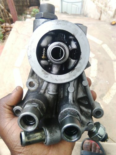

Postby scoobert_doo » June 28th, 2015, 12:53 pm
This is the oil filter housing I bought for my l200....is that spring plunger suppose to block the hole it's over or is there supposed to be a space between the bottom of the plunger and the hole?? Someone please help......

Postby scoobert_doo » June 29th, 2015, 6:22 am
Will this work on my 4d56t? Im concerned about the gap between the spring device and the hole below it.
