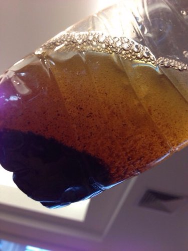

Postby insidious76 » October 31st, 2014, 1:59 pm
Hey guys, be careful, my van shut down on the Lady Young yesterday! I managed to get it back started and when other mechanic checked it out, he told me it was some bad diesel! He drained out some in a soft drink bottle and sure enough, it had plenty sediments in it. I think I should start using Unipet double filtered diesel?has anyone experienced this before?

Postby VexXx Dogg » October 31st, 2014, 7:33 pm
Ok, where did you last fill?
When last was your fuel filter changed?

Postby DrunkenMaster16 » November 1st, 2014, 12:10 pm
Had this happen to me twice, mazda BT-50 WL.
Took down the fuel tank flushed it with clean fresh diesel. Let it dry completely mounted it back and filled with clean diesel. manually pumped and drained the OLD filter multiple times until the diesel came out "clean" changed the old filter for a new one, cleaned the micro filter by the tb/ just before the injectors. Drove straight to a trusted station filled and ran the highway. 100% back to normal.
I stick to a few stations for this reason. NP duncan village, NP Mon repos, Unipet point a Pierre rd, Unipet brentwood, NP tragrete road, NP Beetham, etc etc etc.. these stations i have personally never had bad experiences.
NP on the cross I got water and particles of metal, and a few other stations that I will not bother listing.

Just got my van back from mech. Was indeed bad diesel; had to drop tank and flush everything. Clean injectors etc. lots of $$ later and my van is back to normal

My hilux stalled saturday 6th dec 2014 after fillin up at the new NP on the cross sando - usually fill they without problems before! Check out the sample of what came out from my tank- photo attached

Questions
What mileage is the van currently doing and how often was the fuel filter replaced.
I am currently monitoring the contaminants that the sedimenter is collecting and after 4000kms. ..I probably have about a third of what you have there.
Now the contaminants in the bottle I have collected takes about 2 days to settle out if I shake it...makes me wonder what happens when they are replinishing fuel in the storage tanks.
