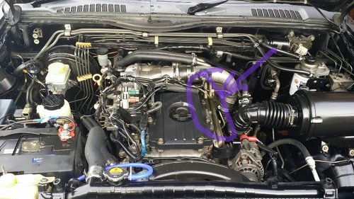

Fellas I need your help... see the item circle off in the pic the 2 lines ? What is the proper name for said item and where could I get to purchase it?

Details wrote:Fellas I need your help... see the item circle off in the pic the 2 lines ? What is the proper name for said item and where could I get to purchase it?
Those lines are there to recirculate hot water inside the vehicle to the heater core for you to get hot air inside the van via the a/c controls. If they are leaking you can simply put end caps on them.
some aluminum welding should do the trick
Thanks Fellas who you guys suggest I go by to get the welding done? You think a/c technician could handle something like that ? I were to change it altogether you think the motorist would have said item ?...

Postby sliderz1 » October 9th, 2014, 2:58 pm
auto ac guys should be able to handle aluminum welding.
if motorist doesnt have it they'll order it

Go the part by the motorist for $380.00

Postby cressida_override » October 10th, 2014, 5:26 pm
why did you need to repair or replace the lines for though, rust at the ends? or you think its leaking?

Postby Details » October 10th, 2014, 8:48 pm
cressida_override wrote:why did you need to repair or replace the lines for though, rust at the ends? or you think its leaking?
My coolant kept leaking out and there was no sign of a leak any where ... I did a number of changes eg. New oem radiator cap, water pump, oem thermostat, overflow hose, oem radiator hose top and bottom and oem new radiator.. and it still kept leaking I was in fear that I had to change the head gasket or worse the head which cost and excess of $8000 at massy... and on Monday I realize it was leaking from the hose it was really bad ... so I replaced them today I would still get the old set repaired as well and keep it as a back up...
