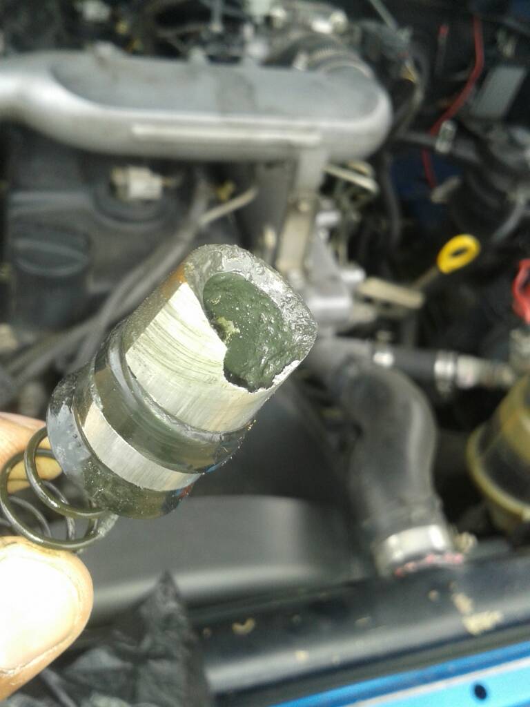

Slave cylinder. Factory. After 500,000kms

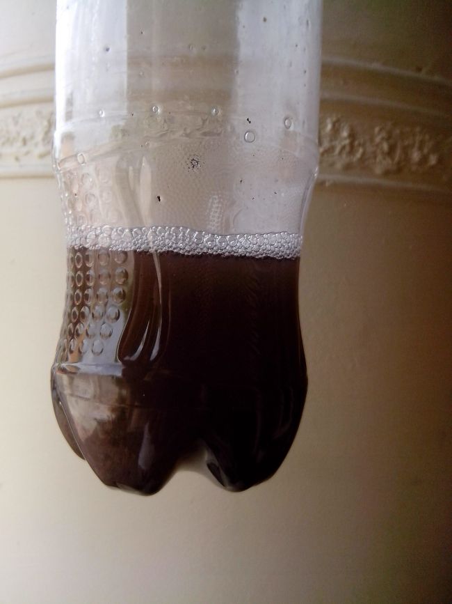

kamakazi, This is a pic of the Diesel fuel that came out of my Tank. My pickup is just 10months old doing 15000km. It was clearly contaminated Diesel, they had to remove the tank, drain all the fuel, blow out the lines and replace the fuel filter. Vehicle back in order.
I've heard alot of people had issues with Unipet(Except People From this Site), even the pump attendants was telling me alot of people was affected by this bad diesel. The Diesel pump at this station was down for repairs last week...
I gave them a sample of the fuel, so they are running some test

Damn. Looks like chocolate.
I think its a hit and miss. A while bqck I went to four different stations and got samples of diesel. I had a thread on this somewhere on tuner. The dirtiest diesel came from new np stations. The cleanest came from the old stations. I got the best diesel from unipet.

Ouch. .. thats not pretty
Glad to hear you got it sorted
Sedimentor might have to be drained 3 -5 times to handle that amount of contamination. ... Hope the filter kept most of that away from the rail
All the best man

Same thing we were getting. As posted hefore it ended up being this along with main cylinder. When you press the clutch you get a rough feel towards the end

So your slave cylinder failed and you had to change the whole thing? Or just the plunger inside?

Easier to change the whole thing. Reliability factor
