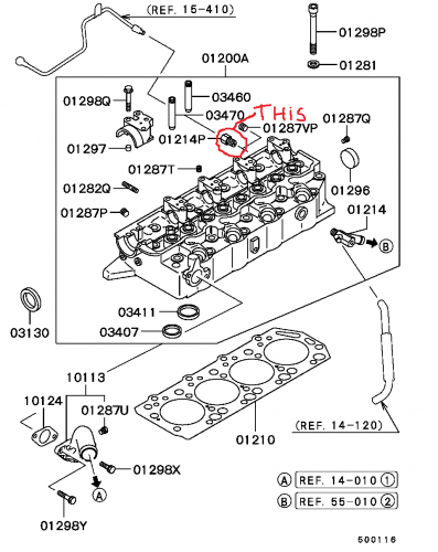

hey guys! hows everything...!
i am in need of a very small part off of a 4D56 Head... turbo.. its a restrictor for the inlet line for the turbo, it screws into the head and the oil feed line to the turbo screws into that.. i have a pic of it here... any assistance will be greatly appreciated.. thanks in advance..

i got it in bamboo..
