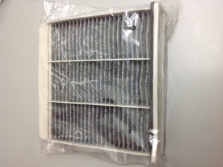

Hey DVSTT, no I did not add one in, I opened up mines, saw the cabin filter, took it out and carried it along with me when I was looking for the replacement

For some reason DM imports the Sportero without an A/C filter. If you found one already installed, there is a great possibility we installed it for DM at our shop when we replaced the evaporator.

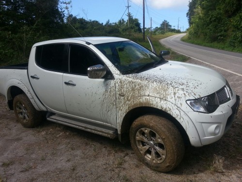

Virgin offroad run, both me and my new used truck. Went on a trail to Rincon on the north coast led by my experienced cousin/parter in crime with a zuki jimny. Then came out and took a another trail to the beach alongside las cuevas.
Got a chance to play with 4wd a bit; had truckloads of fun. Learned a thing or three about offroading and mud, as well as handling my pickup on the maracas curves. (coming down from maracas is much harder than going up, especially when learning vehicle dynamics on a truck!)
Can't wait to do it again, but with better shoes (these Michelin Lats HTs are almost ready to be changed out)
Plus I realized after two weeks of ownership, I didnt have the wheel locknut key, I felt blessed/lucky to find a tyre shop in Petit Bourg who was open today of all days. The dude figured out how to remove them. Got a quick replacement for under a hundrex bux.
Whew. Tired like a dog now.
Mud under le truck and wasa pressure low. Gotta carry her for an underwash and shock oil!

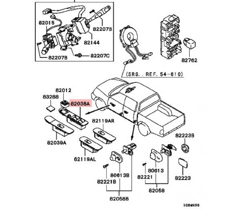

ado15mk3 wrote:Yeh. that was for the power window switch. haven't gotten around to that one yet. will get chassis # today.
hey buddy this is the diagram for you van ...point out the switch you need .
then I can post the part number and get you a price info etc...
this post is for info purpose only ...all part numbers will be posted here for everyone's benefit .
