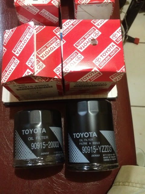

Can you tell the fake?

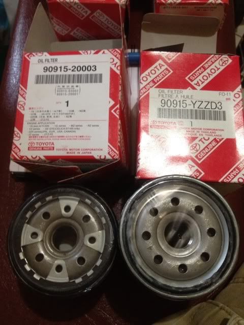

Postby sweeks » October 9th, 2012, 4:40 am

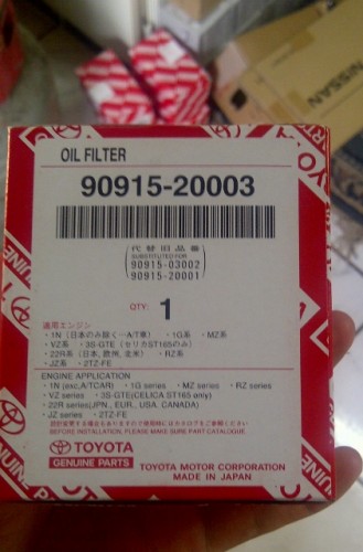

i chose the one on the left because it said made in japan and had 'japanese' writing as opposed to the one that said made in thailand and it had french translation. i really don't know for sure.
good post nevertheless

very difficult to tell which one is fake, the major difference between the two is the size

not necessarily a fake...two different part numbers....two different filters.....
Re: Can you tell the fake?
Postby wagonrunner » October 9th, 2012, 9:51 pm
ranger wrote:not necessarily a fake...two different part numbers....two different filters.....
even though googling toyota 90195-20003 returns nothing?
googling toyota 90195-yzzd3 has lots of info though.
noone in the habit of doing that before they make purchases?

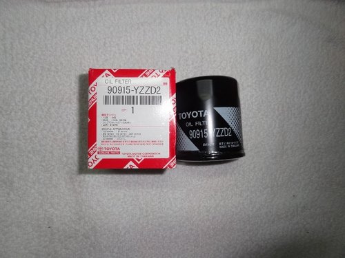

i'm also seeing this as being the correct filter for my truck
Genuine Toyota Hilux Fortuner SR5 MK6 MK7 2011-12 Engine Oil Filter 90915-YZZD2
my truck was bought from maska and all you pay for is parts (i.e oil, filters) my service is usually $900-$1100(if i change fuel filter)

The filter on the left turns out to be the fake.
Both part numbers are valid. It's very difficult to tell by just looking at it however the following can help:
- the original Toyota sticker (not found on all boxes but on the d4d oil filter boxes).
- the original filter has a plastic seal over the filter opening to prevent any dust particles from entering the filter.
- believe it or not TTTL uses the original filter for two oil changes (I've used them up to 16000km).
- know and trust your supplier bearing in mind that cheaper isn't always better. Most parts place will resale to make an extra dollar. It's your respondsibility to ensure that whatever you parts your vehicle uses will be safe and protect your investment in the long run.
Thanks for all your input and thanks Aaron for the photos.

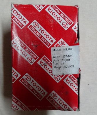

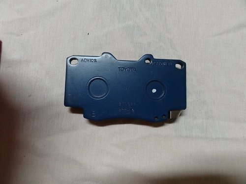

I added The pics of the Cases for Oil Filter and Disc Pads for vigo/ Fortuner , need to confirm if 2012 running the same setup..
This is just what to look for when buying these products...

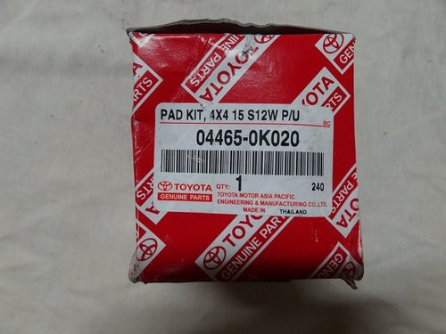

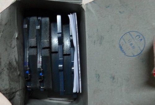

How the actual Disc pad looks
Part no. Thailand Made.. Japan uses the same number as there is a Japanese made part with same number.
Comes with instruction booklet..lol
Original Advics Make Disc Pads..For those who dont know check any toyota Software you will see the brand Advics come up..It genuine Toyota..
Hilux advics dics pads.JPG (73.56 KiB) Viewed 11135 times

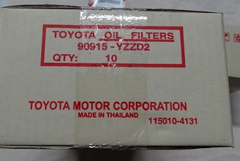

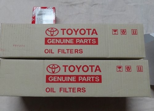

Original case comes with Lot number
toyota oil case.JPG (46.32 KiB) Viewed 11135 times
Original Oil filter Case from Thailand Just FYI

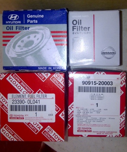

hey guys ,
Just to add to this discussion , Toyota is not the only brand with multiple filters for the same Van , See attached for the navara from nissan .
The grey filter is sold by nissan Thailand(used by import maska mrampersad etc) , the black is made by nissan Europe (used by neal and massy) both are inter -changeable and I have heard that the grey one is fake as well. The best defense is buy from trusted suppliers, in opening i faced issues of my parts being fake and customers skeptical , but any honest business can work through this as alot of tuners have used my parts and saved, and can easily recommend me .
Just be careful and examine your products properly before buying...
