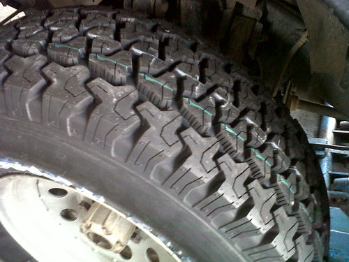

OK, so I bought the 31x10.5-15 Firestone Destination AVTs. Question: What pressure to run these on my frontier (front wheels)?
The tire shop put 30psi but last week when I bought a used Michelin from another shop they put 35psi for the back wheel.
So what pressure? Mostly road but regular grass road.

AdamB wrote:OK, so I bought the 31x10.5-15 Firestone Destination AVTs. Question: What pressure to run these on my frontier (front wheels)?
30 psi is fine. 35 psi is too much IMO

30psi is ok, what u need to do is monitor how the tire makes contact with the floor, if the edges not touching then its over inflated, lose some air, but seeing as u in agri, be mindful of what kind of weight u hauling around.......
i run F30/R28 in my surf, but i find its too bouncy and gets too much wheelspin when cornering, so i drop to F26/R24, which is a bit better.........

Thanks guys, I just want to make sure that the tyre pressure don't cause a problem with cutting badly.
I noticed the edge of the (front) tyres touching the mud flap when locking all the way. I raised the front by cranking the torsion bars, it helped but still touching a little. I may have to remove the mud flap??
I thought that size tyre would have been no problem but I guess I was wrong!

AdamB wrote:Thanks guys, I just want to make sure that the tyre pressure don't cause a problem with cutting badly.
is it me, or does the wheel space here look very small, if the rear is higher than the front and u dont have much more to wind up, u may need to get some better torsions....
Actually, I took the photos before raising the front, it's a lot higher now but still touching. I used rims from an old hilux 15" and left the 16" steelies with the road tyres as a complete spare set.

have me thinking now... if i do eventually get the 31 x 10.5 x 15 that i'll have to remove the mud flap, which i dont want to

tr1ad wrote:have me thinking now... if i do eventually get the 31 x 10.5 x 15 that i'll have to remove the mud flap, which i dont want to
given the pic you posted of the van....it should fit
it'll depend on how high your torsion is cranked, how levelled the van is and consider the offset of the rim
or do a simple lift like Adil, easy and it works

tr1ad, you should not have to crank or remove the flaps with 31s, it may all depend on the width and offset of the rims and if the torsions were dropped before...

...or jus trim the inner part of the mud flap....problem solved.
