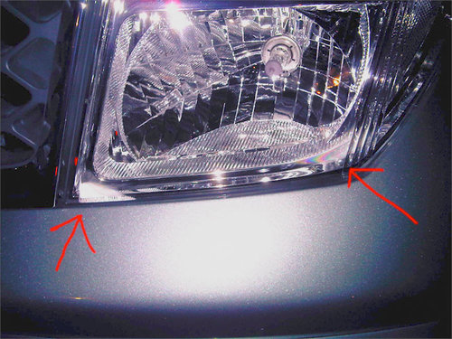

Got my Nav yesterday. Installed the Greddy turbo timer last night.
Need to go back to do the Rust Proofing on Saturday morning.
Noticed a little condensation in the left headlight, both bottom corners. Spoke to my sales rep this morning and he said point it out to the service department when I go in for my 1st service and they will sort it out.
Other than that everything seems fine. Got it will about 80KM on the odometer. I cross 200KM on the odometer this morning though.. :oops:

That condensation normal, will disappear. Happen if u wash the vehicle when the engine still hot

Probably...
Anything else to "look out for" ?
:D
Check it out the headlight here.
Aaron 2NR
Posts: 6476
Tech Thread - Nissan Frontier, Navara, Pathfinder.
Postby Aaron 2NR » March 28th, 2012, 1:35 pm
Yep that's normal. It goes away once the engine cools down. Nothing to worry about, that happen to almost every vehicle
trvs
Posts: 891
Joined: May 23rd, 2008, 1:13 am
Re: Tech Thread - Nissan Frontier, Navara, Pathfinder.
Postby trvs » March 28th, 2012, 1:38 pm
Okay thanks man. :)

About the condensation - daiz normal ting. When I first bought my nav, the next morning I went outside to go admire it (woke up early before everyone else so no one would see me) and I noticed the left foglight was full of condensation. Called my salesman later and he said yah daiz normal, it's from when they park up the vans for so long in the bond/N&M compound. The condensation went away after a couple days of hot sun and night driving with headlights/fogs on.
