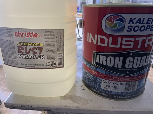

matix wrote:New zinc ( etch primer, grey oxide, paint)
I use kaleidoscope on all the jobs and it holds out really good.
And yes the grey primer works really good.
Next time I will try that brand Cause I didn't have success with whichever brand I had used .
Resorted to just paint normal ... And it flake off,,, as expected
Posts: 29325
Re: ZINC RHS ADVICE NEEDED
Postby pugboy » September 4th, 2024, 7:25 am
what works for sure is spraying or painting wonder rust remover which etches the zinc as it is an acid then regular primer
then rinse off
but wonder ain’t cheap
