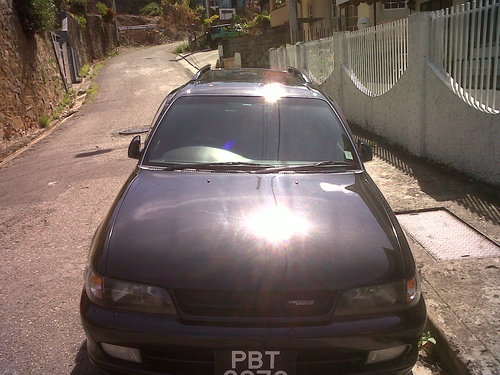

Postby Xplode » February 23rd, 2022, 1:11 am
My AE111 wagon and BZ back in the days .
