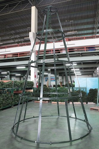

I have a metal frame work tree. I got a white/blue tape led light and ran it on the frame work of it. The tape dont have a dimming feature. That was really hard to connect up..i mini zipped tie it on. Now when I light it up , I found its too bright like the sun because all the lights are too concentrated and it spoiling my overall decoration look.
Without having to take out and buy a set with dimming feature , what else can I do to dim the lights?
I was thinking of covering it with garbage bag to reduce light brightness. Any other safer and easier solutions?

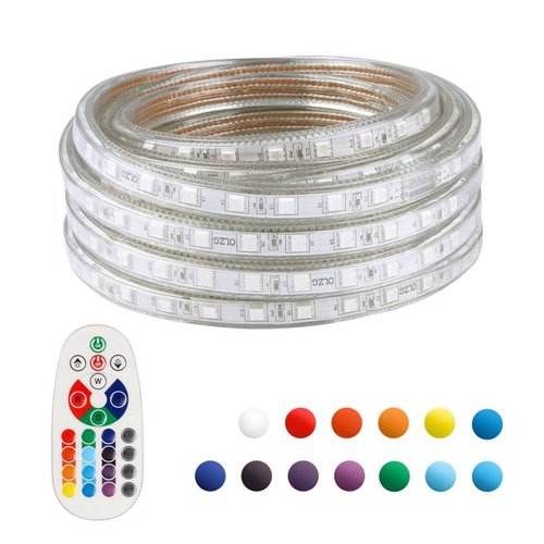

The led light pic is just a sample...it does not have color changing and dimming feature. I got the tape lights from Pricesmart.

Tape will be cumbersome to apply.
Option1: You can try the VHT nightshade spray on it.
Option2: Paint the metalwork matte white and mount the LED face down with a gap. Can use some kind of spacer to allow a 1/4" gap or so. More gap is more light reflected (to the point of diminishing returns), so experiment with diff thickness spacers.
I think option 2 is better.

Get an adjustable controller for it
It will allow you to change the brightness

Post a pic of the controller boz that's connected to yours. Most of them are standard and interchangeable
Re: How to Dim led tape lights
Postby aaron17 » November 24th, 2021, 1:32 pm
I checked the led ...its not meant to be dimmed...its either on or off

It's led, what are you using to power it?
Just lower the voltage.
