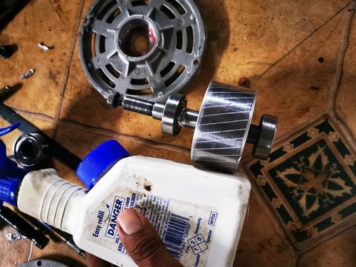

Re: I need a 5/8

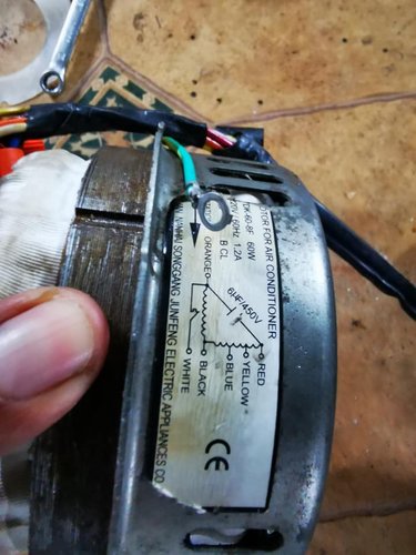

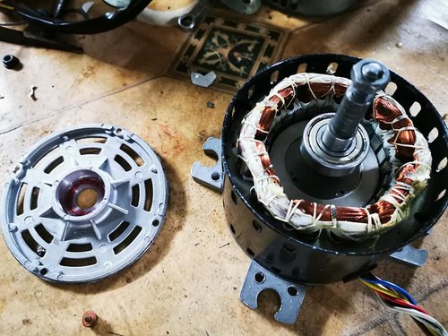

Postby nervewrecker » October 20th, 2020, 9:24 pm
first motor, original motor

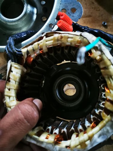

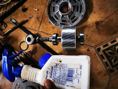

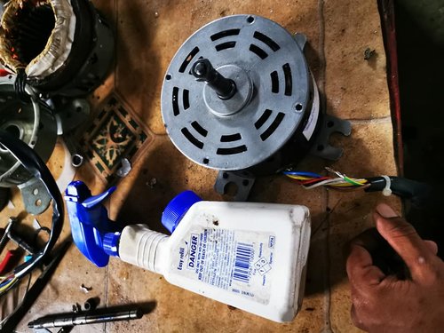

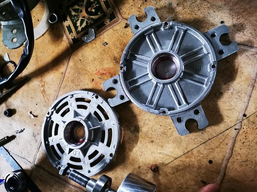

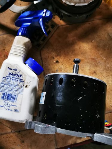

Re: I need a 5/8
Postby nervewrecker » October 20th, 2020, 9:31 pm
second motor

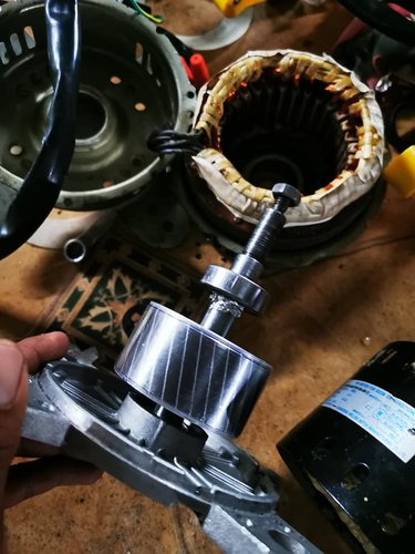

Re: I need a 5/8" shaft balanced.
Postby nervewrecker » October 20th, 2020, 11:01 pm
When we run it on the lathe, we saw that it bent.
Both bent.
How, why?
As they said, sheit happens. It's not uncommon to see such.
Tested a new one today, straight off the shelf and it had noise. Posted it in the group and my peers abroad says that's not how they work. Something is wrong. One raised the issue that maybe it needs load, one was run with load and made a lot of noise.
They all got good voltage, current, right size cap etc and we're tested at more than one places.
Tested one for a short period and it got very hot. No poling issues. Ted and I put toothpaste on the rotor and spin it inside the stator. No rubbing. Even tried balancing the rotor, no success.
What odd is one bearing have play on it and it was just installed. Bearing removed with a bearing puller. New bearing actually fit a little loose hence the piece of foil on the shaft to hold it in place a bit. Bearings not installed bent as well. All that checked out, it's about 3 pairs of bearings I pass through. All brand new skf from United bearings. Still can't be any cause of any of the above issues.
The second set of motors are not meant for the system I trying to fit them in. Noise will be neglible on the system they designed for. It's very compact with a lot of bracing. The system I trying to fit it in has huge panels and a lot of empty space. Imagine your cellphone vibrating on a solid concrete kitchen counter and same phone vibrating on a large hollow wooden counter or even in an office desk drawer.
This much effort is being put in because this is my biggest client and the owner of said company bedroom unit. It's priority to me.
Unfortunately he said replace the entire unit and fix this one for use elsewhere on one of the compound. Very understanding client and very humble person.
