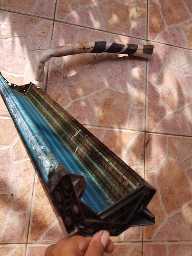

boi i does jus take out the front, take out the drip tray , take out the long blower wheel , spray the coil with a cleaner i buy from a place in el socorro , it does foam up take the hose wash it out and wash out the drain line mount it back up, take the pressha washer and presha wash the part outside and i done. take about 20-30 min per unit.

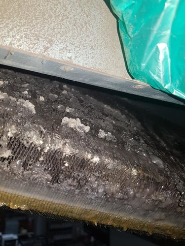

lol @ scam, back of the coils in a 5 tonne. Blower motor have to drop, that alone is a 2 man job. And by 5 tonne I mean 5 tonne, not them micky mouse thing alyuh accusomed to.
3 layers thick, spray alyuh lil spray in the front and save $$$, it will cost more in the long run. :fadein:

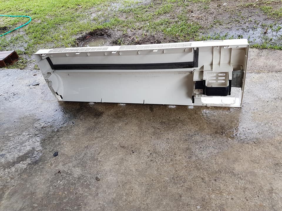

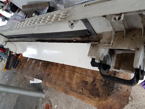

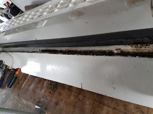

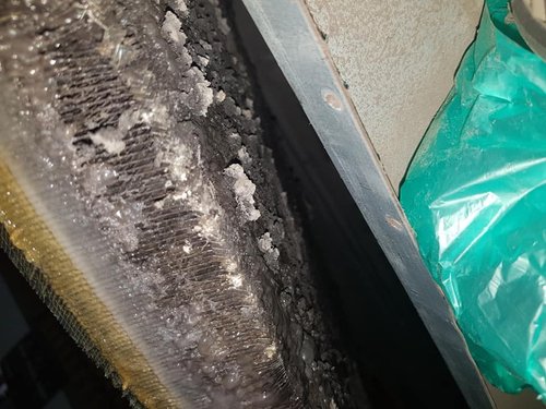

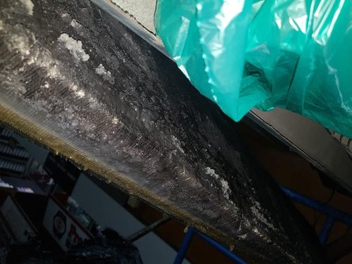

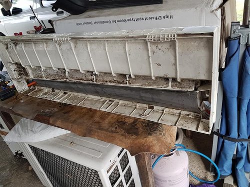

Postby nervewrecker » February 8th, 2020, 8:02 am
https://www.facebook.com/pg/ParsotanAC/ ... 2410583467
newer units, the front drain pan cant be removed.
The back and rear drain pan shown here.
Routine servicing as done by I dont know who. The top of the coil actually sits in the back drain pan so unless you know what you doing, you gunna pay more in the long run.

Postby nervewrecker » February 8th, 2020, 6:19 pm
Normel.
4 more on the next sideImage
