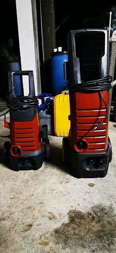

Both of mines developed the same issue. One, the motor short cycling with the trigger not depressed due to leak on the head and the other just running right through.
I scrapped both and repaired them. Opened the heads, serviced and sealed them proper, changed oil etc.
I have one in service. The next, I think forgot to put back the connection on the capacitor.
Both coated with heresite vr-514 anti corrosion coating.

You replaced the part of attempted to seal it?
The karchers you cannot try and epoxy or seal it.
The second time I bought the part online and fixed it myself.
The karcher motors are strong but I wouldn’t service by hadden

I roughed up the surfaces and used some gasket sealant on them.
Left to cure 24 hours and so far no issues with one.
I will try the other when I get a chance.
It literally took me 15 minutes to do the smaller one as I had some practice on the bigger one and the smaller one was far easier to do as it was lighter

The problem really is that when you release the trigger, the pump still runs for a split second which then triggers a plunger in the manifold which then switches off the unit.
It is during that split second when the pressure builds that the little extra pressure will damage or split the manifold.
Switching off and then opening trigger may help but just the act of releasing trigger still causes the pressure buildup as that is how it is designed.

Also if the plunger which moves the switch to go off is sticky then it will also be a problem.
But in both cases with me
It split on a seam Of the plastic molding
So I more feel the mfg process of the plastic manifold is inferior

believe it or not my karcher follow me k3 plastic manifold cracked again two weeks ago
bought the part by hadden and fixed it myself(3rd time) $280
then a week later my sister's own suffered same fate.
I suspect the reason they split is they use an oring which is too large and it is pressed in with plenty force.
This was quite obvious when seeing the big split in the plastic.
I put in a thinner oring, hope it lasts longer.
Hadden says only the K5 model and up meant to be used for more than 30mins at a time.
