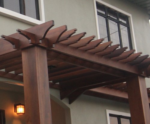

I use Minwax Helmsman Spar Urethane on a greenheart pergola and get years before refinishing. And it's on the eastern / windward side of the house. The Satin finish lasts longer than the gloss and looks better too IMO. Try multiple coats with a brush.

Hey Duane, how did you get that dark finish. Was it the spar urethane?

no I used Sissons American Walnut wood stain and wiped it on with a cloth. The Spar urethane is clear satin.
