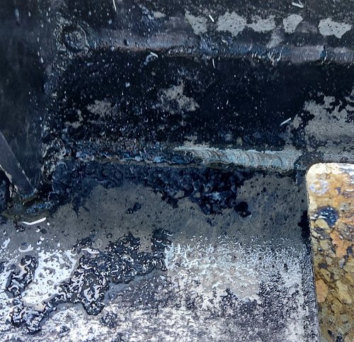

Does the whitish and black foam residue from wonder plus rust remover prevent paint adhesion? If yes, whats the best way to remove, wiping, brushing off, washing?
I used it on a piece of new c channel with some mill scale left after wire brushing and sanding , no rust was really there but i wanted the chemical coat as a primer before i put grey oxide.

I cleaned the steel with wire brush and sandpaper
Then applied wonder plus
The next day i checked it and it had a black coating (which i expected) but it was rough and uneven like foam but hard and crispy like a crust and can come off, some parts easy to scrape with finger nails and other spots not so easy. The whitish residue can wash off its not difficult to remove. I tried scrubbing with a scrubbing brush but not much help.
I dont think this black crust shud get coated with grey oxide primer because im sure it'll just flake off with gentle rubs nocks or grasping firmly with hands.
Any idea what to do about this crust and how to remove?
Below it is a dull light grey finish on the bare steel.
Posts: 29319
Re: Wonder rust remover on steel beams
Postby pugboy » January 15th, 2021, 12:20 pm
steel brush should take it off
