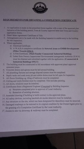

rnlsouth
Posts: 29
Joined: March 3rd, 2009, 7:15 pm
Re: Completion Certificate Requirements
Postby rnlsouth » February 27th, 2018, 6:02 pm
Thanks for the responses. Great info.
I was able to get a list of requirements. See attached.
Thanks again.

The completion certificate is supposed to be issued by the district public health inspector ,county medical officer of health , this is hardly adhered too by the local govt, ... But soon by law it must happen

Postby De Dragon » February 28th, 2018, 9:14 pm
13. Amended drawing if building is build contrary to the approved plans.
My God, must we show our backwardness in everything?
