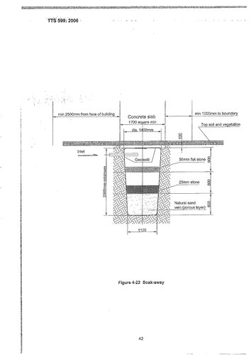

Just go with the recommended design for the soakaway on page 42 of the Trinidad and Tobago Standard "Guide to the Design and Construction of Small Buildings TTS 599: 2006".

This illustration shows you that the bottom of the pit should be in a "natural sand vein" that is at least 800 mm deep. You don't get to see that every time in some places.
This illustration can probably be blamed for more than a few of the premature failures of soak aways built locally. About five different posters already said that you need porous, well-drained soil. That is simply not the case in many areas but some people build it like that anyway because it's in the handbook. .
Rory Phoulorie wrote:Just go with the recommended design for the soakaway on page 42 of the Trinidad and Tobago Standard "Guide to the Design and Construction of Small Buildings TTS 599: 2006".

adnj wrote:This illustration shows you that the bottom of the pit should be in a "natural sand vein" that is at least 800 mm deep. You don't get to see that every time in some places.
With respect to the type of sewage treatment system that you would use for a development, you should do what is called a Percolation test. This will guide you on whether you could use a soakaway, an absorption trench or whether some other type of treatment system is required.
WASA will dictate where the Percolation tests should be done and they will witness the tests being conducted. WASA will then advise you on the sewage treatment system that should be used at your site.
The natural sand vein in the illustration does not mean that there sand needs to be naturally occurring at the site. It means that you need to place a layer of naturally occurring sand (as opposed to manufactured sand) in your soakaway.
WASA is the authority that will indicate the type of sewage treatment system that should be used at a site being developed and this will be determined from the percolation rate of the soil at the site.

I'm sorry to disagree but that particular illustration is for sandy soil. There are different ways to build soak aways including surrounding the pit with sand and filling it with boulders. But you still need evaporation and filtration to eliminate the discharge.
Your design, again, will depend on water table, available space, soil type, and grade. There's more to it than just an absorption/percolation test.
Rory Phoulorie wrote:With respect to the type of sewage treatment system that you would use for a development, you should do what is called a Percolation test. This will guide you on whether you could use a soakaway, an absorption trench or whether some other type of treatment system is required.
As I said above, it depends. If the septic tank is properly sized and you have the space, a large soak away with a leech field is typically the most effective. The soak away acts as a distribution box. Other than that you're heading into coffins, aerators and electrical cables.
