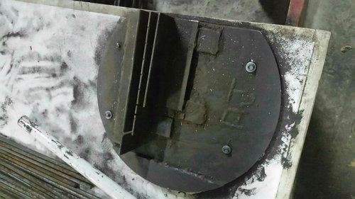

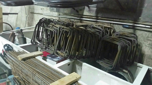

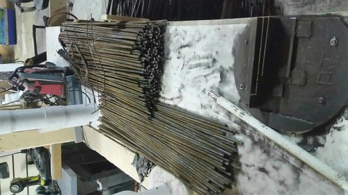

And this is where I am at.. using my house plan and basic maths.. i worked out how much Stirrups for my ground beams i needed and how much piles my house gonna have..
I made this jig
My ground beams gonna be 12" x 10" so my stirrups are being bent 10" x 8"
How much hundreds down...how much hundreds to go

You using a traditional type bending setup
You ever see the other kind which uses pins and pivots ?
https://m.youtube.com/watch?v=exEG_sEpH5A
I made one but not sure if it would be faster but it works good.
