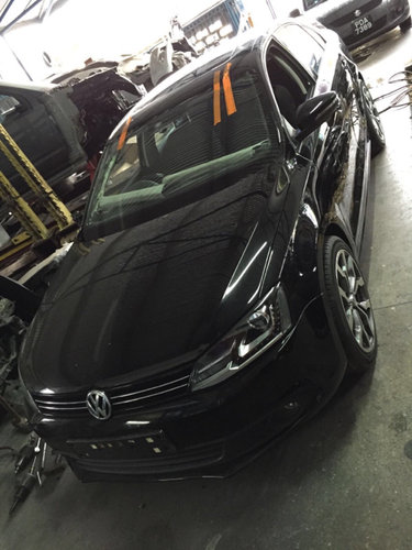

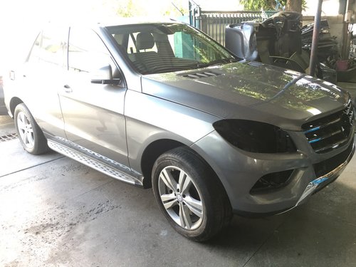

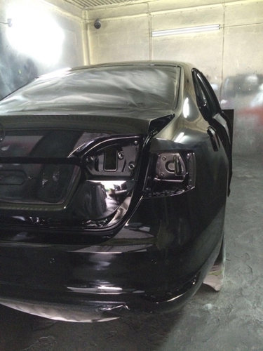

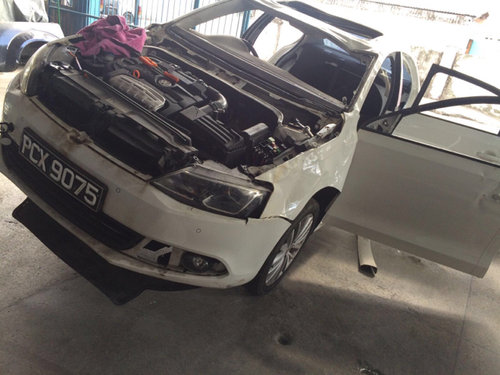

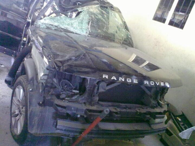

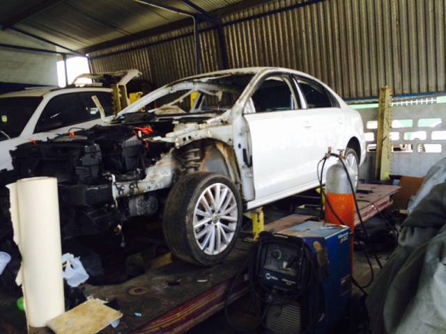

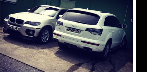

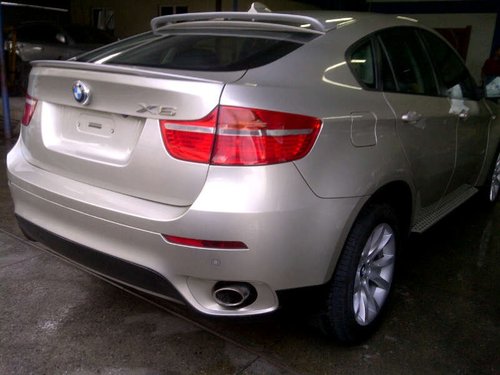

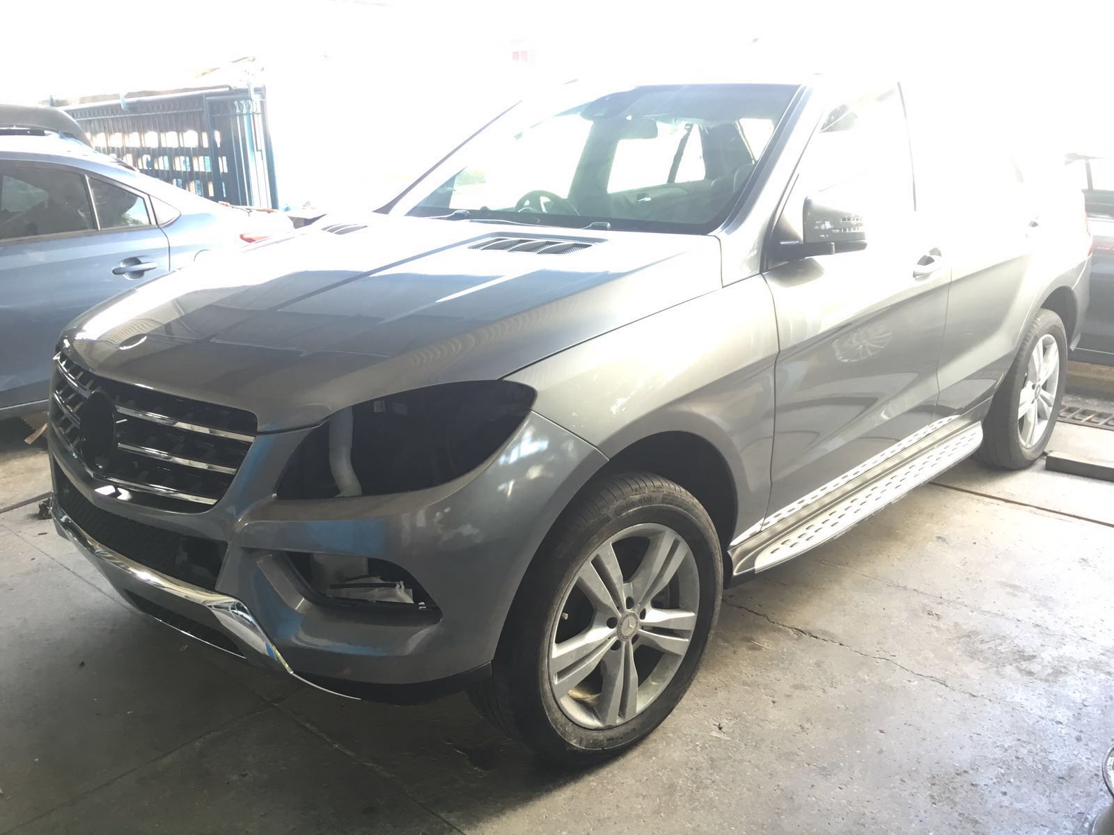

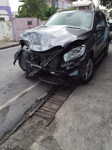

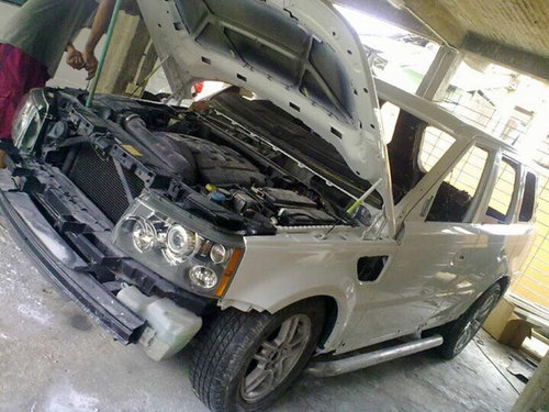

Re: the way body repair should be done (youtube video)
Postby rspann » November 10th, 2016, 8:00 pm
Heres a few. Q7, Jetta and Range, all were rollovers.
Postby rspann » November 10th, 2016, 8:04 pm

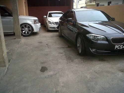

one more,all these were on Tuner so I didn't have to look far.
Postby rspann » November 10th, 2016, 8:21 pm
Hold this,also from Tuner.
photo %287%29.JPG (51.85 KiB) Viewed 5267 times
