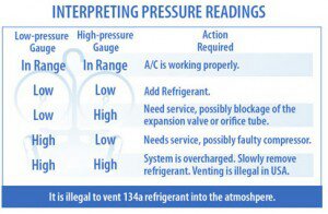

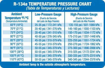

R.P.J wrote:Temp-pressure-chart-33776F1.jpgr134apc1-300x196.jpg
Ok guys so what reading would give you a properly charge system.
if you have the following scenarios :
no gas in system
1. - system already pressure tested & vacuumed - ready to accept refrigerant - check sticker and weigh out refrigerant...and add in. - no sticker on vehicle proceed to #2
2. check outside thermometer for ambient temp....then check the relevant pressure reading for the gauge and SLOWLY add in refrigerant.... - insert long stem thermometer into ac vent to check the temperature drop before and after. stop adding refrigerant wen desired pressure is reached.
system does not have enough Gas - note - if a sticker is present there is NO way of knowing how much refrigerant is currently in the system so you will have to proceed accordingly.
1. connect gauge and check the pressure readings...insert long stem thermometer into AC vent and check temperature. check outside thermometer for ambient temp....start adding refrigerant in the system slowly until the desired pressure is reached.... check temp inside vehicle.... let compressor cycle a few times so to get an avg temp inside the vehicle.
if I was an AC tech....that's how I would do it.
mango tree AC techs feel free to weigh in....

Pressure values also vary greatly from one tech to the other, with each saying theirs is correct.
Consider that maybe all of them use the same pressure values for everything from Nissan to Benz. My 15 year old Mazda uses the same values as a 1 year old vehicle? I think not, yet i have seen it done.
High/Low pressure values should only be used to troubleshoot and not as a measure of if there is enough gas in the system.

Not supposed to use pressure alone either. If place is cold and there isnt much heat to dissipate the pressure will read low so you keep adding.
As soon as things heat up the pressure will go up and guess what.... your system overcharged.
The original question was if you can use pressure to find out if a system is properly charged. I replied yes and I stand by my answer. If I'm not mistaken I said pressure and temp, not so?
The original question also asked if you can use weight. The answer is also yes but you don't have to.
If someone comes in and want to know if they have enough refrigerant in their system are you going to take it out and weigh it? Leme hear you smartasses now...

I think all your questions would be answered with this link
http://m.inspectapedia.com/site/inspect ... s.php#2752
Basically it pointed out that using pressure as measurement, 'assumes' a temperature between room temperature and body temperature for refrigerants. So i suppose this is the official method and would work just fine as long as ur not gassing outside that temperature range. But basically the same thing i said.. they wrk with psi, rate of expansion and temperature to fill and measure the volume. But doesnt seem to be a necessity since basically, theyve done all those calculations for u already and all is included as the standard regarding the design of the container. So according to what i read there.. yes nerve u are right, just use pressure. With the bluesclues note that that works as long as ur not dealing with temperatures outside the normal working range. If for whatever reason while driving your refrigerant cylinder gets hotter than average then you would most likely suffer overcharging symptoms as each additional degree will increase the pressure in the container beyond the range it was measured and designed to handle for the ac to work most efficiently.
This give me an idea to ceramic coat the cylinder as we here in hot trini. Dont know where in the car the cylinder is stored or if it could even get hot, but if it vulnerable to heat, a ceramic coating might do wonders and keep the ac running cool for longer. Wish i could do such experiments... sigh.
