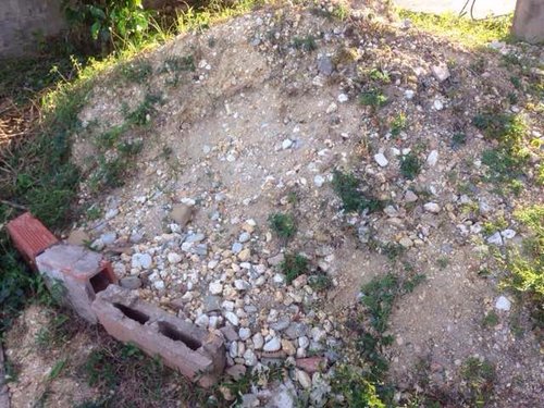

I have for free if you want.....just have to show up with transport and take as much as you want.....there's some silt mixed in though..easiest way to get what you want would be to pull down from the heap with a hoe and pick up the good lose stones with a shovel..it's left over from when I did my rubble drain

Postby MG Man » March 5th, 2016, 6:04 pm
Chase Village
Once u start pulling down the heap, it's mostly stones. It only looks like dirt because it's been sitting there so long
