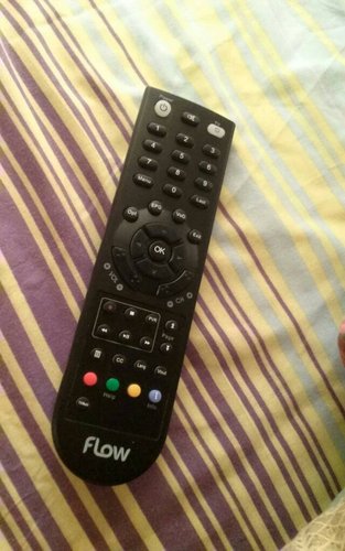

Got my service upgraded to flow HD cable box, however there Isnt any instructions as how to programme the new remote to power on the tv as the old one used too. I called customer service And they too are lost just as me, however i was playing with the remote and the tv button lights up in sequence. Like the old one while programming....... (May have some hope).... Any info on this guys?????? Thanks alot..

Anything under the battery compartment cover?

The paper that came with the remote has all the codes for the various TV's it is by default compatible with Sony TV's.

The remote came with instructions, I'm sure, try holding TV and menu... I programmed mine not too long ago.. It was something like that

With the TV on. Hold the tv and ok button until the TV button starts blinking. it automatically cycling thru the codes here
Hold it pointed toward the tv until it turns off.
When the TV turns off, immediately press the volume up button to lock in the current code.
Just did that and it worked for me.
