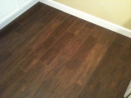

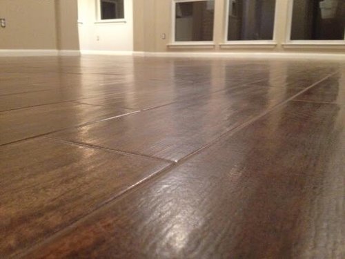

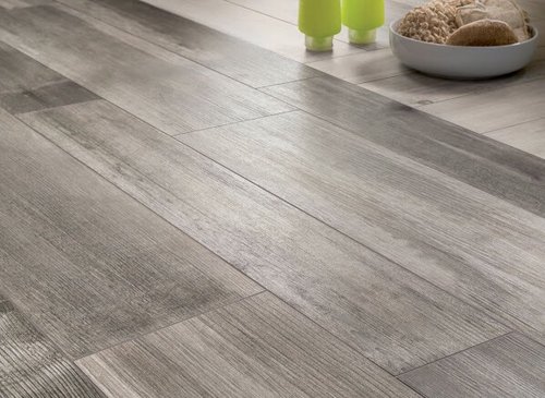

Wood grain porcelain tile
Looks like real wood, water resistant and maintenance free, adds property value, non-skid, available locally.

that tile flooring looks nice, but i am wondering if it will hold up.....
tile warehouse just quoted me for 24x24 porcelain non skid tile with all material is $8500
so that is an option, providing the floor is good enough to put tile as is..
at 900 sq. ft 5$ a sq. ft for labour will bring the total to 13k which is ok
if i have to re-plaster the floor then its over budget for sure

yeah, have to be real level since they tend to be long and any slant will show up badly

I did a bathroom about 10 years ago with the wood grain porcelain tile and it hasn't scratched or faded at all.
There are many commercial places that have it on their floor and it is 10x stronger than wood or laminate floors. It is porcelain tile after all.

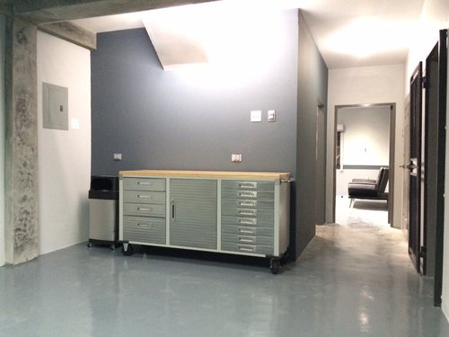

I had a very porous, uneven garage floor and they came in, grind it, applied a polymer, used a isonem waterproofing self leveling screed and then applied a polyaspartic coating on top. Looks like epoxy but stronger than the one you apply yourself.
The floor kinda dirty in this photo. But you get the idea.
You said your surface is not a garage and more than likely you won't have oil, gas, brake fluid and other chemicals on it so you don't need the polyaspartic coating. But the isonem self leveling screed can definitely help.

the porcelain tiles are also square edged and will be harder to lay down. But it looks 100% better than square non-rectified chamfered edge tiles.

those dont look the same and the method of applying the wood grain finish is very different as there is a lot of variation and almost no two tiles in the porcelain or ceramic planks have the same pattern, so it gives that real wood floor look, especially if you use no spacers or no more than 1/16th spacers and a dark grout
square tiles with spacers and grout lines will look like tiles even though it has a wood finish on it, wheras the planks with squared edges look more like real wood especially since they don't have repetitive patterns.

Duane that garage floor looks really good. Was thinking of doing the epoxy finish as well but diy. What was the cost per square foot inclusive of grinding, application of polymer and the other 2 finishes, if you don't mind me asking?

NR8 wrote:Duane that garage floor looks really good. Was thinking of doing the epoxy finish as well but diy. What was the cost per square foot inclusive of grinding, application of polymer and the other 2 finishes, if you don't mind me asking?
I would expect there will be multiple factors affecting the cost of the application as current floor condition etc needs to be taken into account so

it is almost impossible to quote per square foot without seeing the floor and doing some tests first. It can depend on how porous the concrete is, if it is breaking up, how uneven it is, how much grinding needs to be done, how much waterproofing polymer needs to be applied, how much screed is required etc etc
The ISONEM self leveling screed can be a few mm thick and still be strong enough to drive your car or van on for years.
