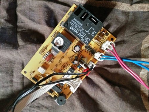

A/C Model: Peake Mini Split
Problem: When the blower unit inside the house is turned off, the compressor unit outside the house continues to run. I have to use the switch that controls the electrical receptacle into which the a/c is plugged in to turn off the entire unit.
Can anyone advise on what could be the problem and how easy it may be to repair?
Thanks.
EFFECTIC DESIGNS
Posts: 9651
Re: Air condition Service
Postby EFFECTIC DESIGNS » November 6th, 2016, 5:35 pm
Rory Phoulorie wrote:A/C Model: Peake Mini Split
Thanks.
I had this same exact problem. The problem is the relay on the circuit board on the inside unit. They also call it a contactor and in big units it looks something like a circuit breaker.
On regular split units its built into the evap circuit board. Its a problem, you need someone skilled to replace it. A board with one of these is $500.
But if you can solder you can replace it for next to nothing.
Can I ask how long now you have this unit? usually the run start capacitor goes bad before this relay. In my case my relay started working normal again on its own after 2 months of being stuck. And has started working ever since. How old is your AC?

cherrypopper
Posts: 1880
Postby cherrypopper » November 6th, 2016, 5:55 pm
This is what it looks like rory

cherrypopper
Posts: 1880
Postby cherrypopper » November 6th, 2016, 7:13 pm
Replacement is easy, getting the part is a task.
The dealers got the part but all of them insisted that i buy a board.
I ended up ebaying the part for less than 100
Postby nervewrecker » November 6th, 2016, 8:17 pm
It's the black box on the board here.

Yup, relay. Mine failed after 6 years of operation 12 hours per day everyday.

Relay failure

Same thing happening with a Panasonic unit installed about 3 years ago.
Condenser was not turning off outside so evaporator coil inside was icing up until you throw the breaker to kill power to the entire unit.
Unit was serviced and it started working again for a couple months but now it started back not switching off so looks like I'll have to get the board.

Btw duane, have him take a look at the Panasonic before you swap board. Boards kinda hard for the Panasonic them. Iirc they have a two speed condensor fan.
If the problem is what I think it is, it cam br fixed.
