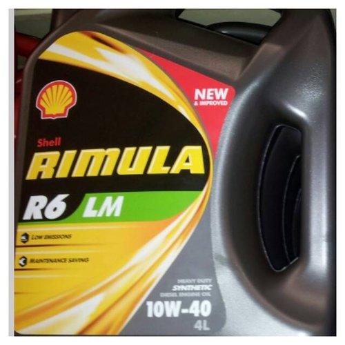

Hey guys I jus wana find out something I have a roro vehicle fully automatic an I have been using shell diesel oil for the last 2 years an I must say my engine sounds really quiet and runs like a beast. Am I the only one doing dis or there is other guys run diesel oil in the gas car.

I uses the shell r6 10w 40. Engine works great. I chnage at every 20k.

Jet wrote:I uses the shell r6 10w 40. Engine works great. I chnage at every 20k.
Some shell oils can be used for both diesel and gas engines nothing new op.
you read the back label on the bottle.

anyone using shell rimula r3 10w40?
Jet
Posts: 274
Joined: June 19th, 2013, 9:01 pm
Re: Diesel Motor Oil in Gas Engine
Postby Jet » April 6th, 2014, 11:34 am
Yea thats the black bottle shell using dat in a 2003 almera works perfect
