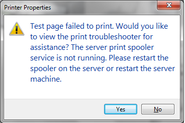

Postby st7 » October 7th, 2013, 11:15 am
did all that and restarted machine. went to the printer (it's state had a GREEN TICK next to it) to print a test page but still got this error.

Postby Racegod » October 12th, 2013, 9:11 am
Give the service a log on account with administrative rights to the local machine. Restart the service and you should be good to go.
