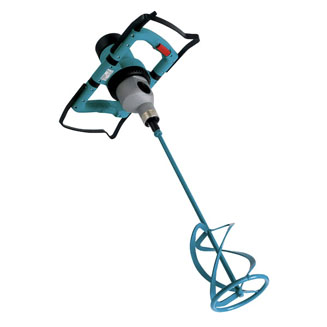

what's the proper way to mix thinset?

@MG Man, the packaging normally has mixing instructions...I have seen thinset mixed without any measurements, they just look a good consistency but this can work either way. According to someone I spoke to already, you mix the thinset until it gets creamy or buttery (this is the consistency you want). He also said to take your tile trowel and rake the thinset, the ridges should stand up and not slump back down. However, this is not rocket science and if you are not mixing the quantity as per the manufacturers recommendations, a little maths can help you along the way to achieving proper consistency and strength.

See they use this attachment 2 ah drill for mixing in a bucket

moving
Posts: 282
Joined: July 14th, 2012, 1:15 pm
Re: wtk: tiling
Postby moving » November 26th, 2012, 4:07 pm
that attachment is the best thing ever.. mixing cement like a boss in no timeeee
