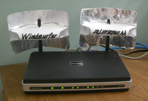

Cooper
3NE2NR Diesel Boyz
Posts: 1525
Re: Increasing router range
Postby Cooper » November 15th, 2012, 2:28 pm
Cid wrote:I downloaded some plans for a diy antenna booster and got really good results... It didn't double the range or anything but it solved my problem... In areas where i got no signal im getting 2 bars now.... Its not alot but its free lol
I tried one of these DIY templates from freeantennas.com, it's called the windsurfer. I used it to get a better signal quality on a system that uses a Dell USB wifi adapter (with no external antenna).
I verified the enhanced signal with a couple WiFi utilities I use at work and the signal quality increased by about 40%. Streaming HD video on youtube as if it were a wired connection now.
I'd suggest you guys try it out before spending money on new equipment. See the example pictured below:
It's basically a parabolic reflector that can direct and enhance radio signals. You can also use it to limit access to your wireless network...depending on the location of the router.
Postby wagonrunner » November 15th, 2012, 2:42 pm
those things help with short range gains. not a replacement for a repeater, to extend gain coverage.
