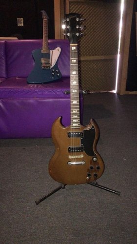

For sale locally. Pretty hefty claim, but pretty famous local artist involved in sale.
Vintage Gibson SG 1961, Owned by Howard Lindeman, used by Sir Paul Mc Cartney on wings debut album.

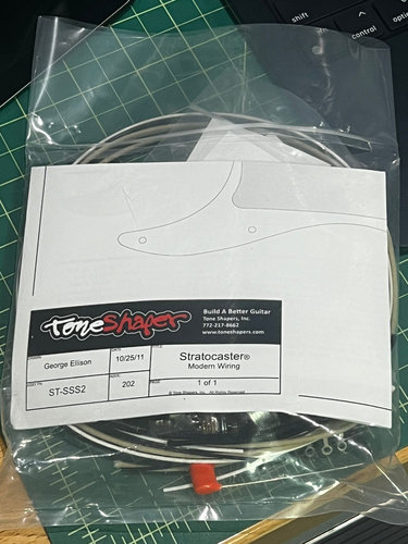

maj. tom I have an el cheapo Fender Starcaster and one of the knobs and pole of the pot broke off. The metal shaft of the pot disintegrated.
I got a Tone Shaper wiring kit with the pots, wires etc. but too chicken to DIY.
How difficult is it to do? YT vids look fairly easy

Postby maj. tom » January 19th, 2024, 1:18 pm
Did you get an HH kit? The Starcaster are 2 humbuckers. Once you have the kits it's quite easy because everything laid out and they have wiring diagrams. But CTS pots are imperial size so you have to drill holes, as the Fender/Squire Starcaster is made in China metric.
The only real trick is reassembly, and I used cutlass wire to get everything back in the holes.

Postby Duane 3NE 2NR » January 19th, 2024, 1:29 pm
maj. tom wrote:Did you get an HH kit? The Starcaster are 2 humbuckers. Once you have the kits it's quite easy because everything laid out and they have wiring diagrams. But CTS pots are imperial size so you have to drill holes, as the Fender/Squire Starcaster is made in China metric.
If you want I'll do it for you.
The serial number on the guitar is CXS
And yes made in China
This is the kit I got. Hope it’s the right one
https://www.amazon.com/ToneShaper-Guita ... B00ZO92VSQ
I bought this since July 2021 during covid and never installed it lol
Re: The guitar string (thread)
Postby maj. tom » January 19th, 2024, 1:39 pm
The switch is wrong for a Starcaster. The right kit is actually this https://toneshapers.com/products/tonesh ... ern-wiring
You sure the guitar you have it's Starcaster and not Stratocaster? Because that's two different designs.
Edit: you better take a picture, because I'm thinking of an old Fender Starcaster that's hollow body.

maj. tom wrote:The switch is wrong for a Starcaster. The right kit is actually this https://toneshapers.com/products/tonesh ... ern-wiring
Definitely a Starcaster
I checked the link - that is 4 POTs and my guitar is 3
Posts: 28732
Postby Duane 3NE 2NR » January 19th, 2024, 5:50 pm
InDeForest wrote:Duane you should have no problems with your diy efforts. Just loosen or remove strings, unscrew the pickguard, trans-plant in the new parts and carefully follow the logic of the diagram, being careful with the tone controls wiring, which often vary from one diagram to the next. Also when soldering, don't dwell on a joint too long and overheat the contacts with the soldering iron, get it hot enough that solder flows well from the contact to the wire, but dont heat the sheit out of it.
OK thanks!
I can solder - have some experience with that lol
I'm thinking to just change that one POT and not all the wiring and all the other POTs
Cause complete rewiring just looking like trouble for inexperienced me
