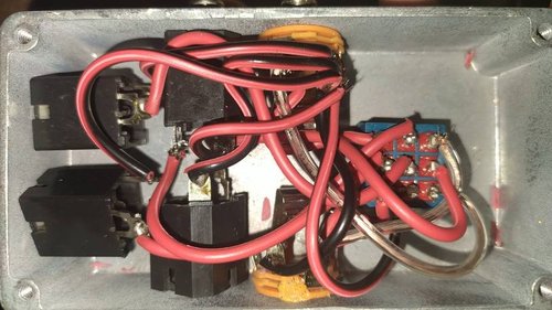

I think my guitar bass fell more than once and something broken. I opened it and saw a loose wire and soldered back but no luck..
Who can you recommend to take a look at it and does repairs.

nismotrinidappa wrote:I think my guitar bass fell more than once and something broken. I opened it and saw a loose wire and soldered back but no luck..
take some pictures of the cavity of your "guitar bass" and post them here.
Why did it fall several times? You're abusing your instrument.
It's very difficult to break the internals of a guitar by throwing it down to the point where there is no sound coming out from the pickups to the output. It will more likely physically break at the headstock or the neck. There is no way a wire could come unstuck from a soldered joint that way. You did a mess in there yourself and shorted it out, or your cable to the amp was shorted before during one of the yanks and falls (this is common).

Family knocked it off the stand more than once. It played after that and then one day nothing. Hence the reason I opened it and then saw the loose wire

Postby nismotrinidappa » May 22nd, 2020, 2:21 pm
Pic
meccalli
Posts: 4595
Location: Valsayn
Re: The guitar string (thread)
Postby meccalli » May 22nd, 2020, 2:49 pm
You make that mess at the bottom? looks like you might've bridged something you shouldn't have or you just might've fried the pot and broke the entire circuit. You can get an old female 1/4 inch plug and bypass the pot just to check. Also, don't use an amp, use your line in or monitor it through headphones if you must use the amp, i figure after a solder job like that, you may pop your cab speaker attempting that lol.
Postby maj. tom » May 22nd, 2020, 3:09 pm
uhhh yeah. It's a mess you see all the solder all over the place there OP?
The black paint is conductive shielding paint also. So it conducts. You have shorted out the entire circuit because you didn't make precise connections.
Best you carry it to an electrician to sort it out and check it with a multi-meter. There are no real specialized skill set required for this fix. It's an easy fix, but you should learn to solder first. There are YouTube tutorials on soldering and i learned from there with some practise.
First, use the multi-meter to check if the pots are still working. Bypass the pot and see if the signal is reaching the output female TS jack. If not, you have to buy a new pot. Remove ALL the solder from the bottom pot with a sucker and some copper braid wire. They sell all that stuff in an electronics store. And just solder it back exactly like you see in the above pots. You noticed how neat and precise they are?
You're following this diagram, which will be useful for the electrician:
2nd, use the multi-meter to check the cable you're using to the amp for proper individual continuity at each end. Like i said before, cables are the number 1 source of trouble and should be checked first.

Sorry about the mess. It's a cheap soldering iron and some really old solder. I don't think I shorted out anything but I will clean up the old solder. I used multimeter and checked cables. I feel it's the guitar cable jack though.

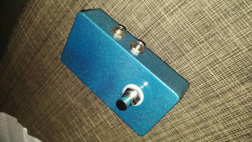

Pics and write up of a diy 2 channel pedal switcher coming soon.Thanks Stev for the parts.
You know how pedals does have fancy names?Looking for suggestions for this one.Is basically to switch from one effects chain to the next(Clean/Distortion) by pressing only one switch.So is either in clean mode or distorted mode at any point in time.
Taking sketches for designs too

Basically is a channel switcher.Either channel A or channel B, not bot at the same time.Reason for building is that it kinda hard to be pressing a zillion pedals while playing.

The new child
