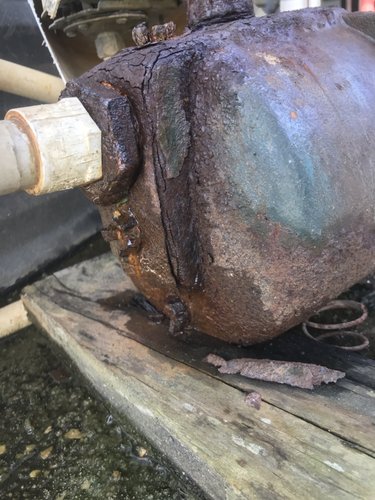

Postby Ted_v2 » June 7th, 2020, 7:21 pm
turns out these stuff needs to be flushed out ever so often, that i never did. im 100 percent sure its some sediment inside that started it.
i have a state select water heater i plan to flush this weekend and take a look at the anode that does rotten

Postby VexXx Dogg » November 15th, 2020, 10:39 am
Yea, my pump man say every year or two give it a scrapdown and clean out. Esp since I don't use filters .
Granted I only see my pump man every 3-4 years when the smart head buss or bearings go bad.... and he does cuss to clean the buildup

VexXx Dogg wrote:
Ted_v2 wrote:IMG_6167.JPG
