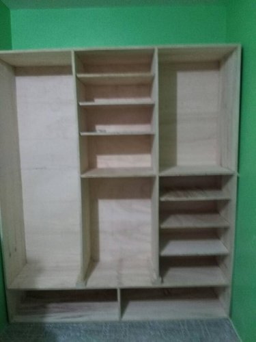

Hey guys.
So I tried my hand at diy with this wardrobe. It not finished yet but just wanted to add my experience so far.
I tried using a software call sketchup to build it but need I need more time to learn it fully. It helps with the visualisation of the process. I also used cutlist organiser ( another program) which helps you reduce waste cuts.
I wanted to purchase material from carpenters edge but bought it instead from those big hardwares to save on cost. Used a circular saw and jigsaw but realised halfway in the circular saw blade was off and I didn't know how to adjust it so went with the jigsaw only at the latter parts of the build.
I also used the kreg pocket hols for the corners and shelves and once it's done properly it's really easy to do. I find their screws very superior to others I have used and plan to use them besides pocket holes.
So the dimensions are 6ft width, 7ft height and 1 1/2 ft depth.
I plan to paint and add drawers to the bottom centre and eventually doors to complete the look.
When I have more I'll add.

U could have used white melamine etc so you won't have to paint it
Looks good

looking good.
best way to cut sheets with a circular saw is to clamp a fence to the left.
use some pieces of 2x2 or 2x4 under the ply to support it, like 3 pieces, 2 from the portion of the ply to the left of the cut and 1 to the right.
Most circular saws the distance from left side of base to the right side of the blade is 5.5" or something like that
some may be to the left side of the blade.
So you just need to make perpendicular marks with a good framing square and clamp a good straight edge 5.5" extra to the left
and run the saw against the straight edge/fence.
It is very common for a circular saw blade to not be in line with the left edge of its base too, this can cause real headache
so you should check that too.
Dont forget woodlice eat ply like ice cream. Termite treatment and sanding sealer helps

Looks good... Just one question. Why didn't you use melamine board instead of ply. You would have gotten a prepared surface with no need to paint .

Wanted the experience of doing it in ply as I'm painting it for my daughters' use and never worked with melamine.

good going , i'm guessing u gonna do a face frame for it
like said above ply is woodlice fav food , treat it indeed , this is why i dont use ply i rather mdf or melamine which is not that much more $ but saves u a TON of work since u dont have to finish it except for d edges , slightl;y harder to work with since u dont want to send screws thru that nice surface so u have to re-engineer ur carpentry to suit
keep us updated
just a btw - almost everybody on youtube puts a straight edge against d base side of d saw further away from d blade , tried that yrssss ago b4 youtube was invented but from ever since i prefer using straight edge by d side closer to d blade
like shown @ 2.39 ... thats just me - choose whichever 1 u like

I find that way coming to the end there is not much support for the saw as it is the narrow strip from right of blade to fence which is holding up the saw
my saw real heavy so it a pia
Re: Carpentry, Joinery and woodworking Forum
Postby Rovin » October 16th, 2019, 11:50 am
what u have : a worm drive saw ? , cause most normal saws more or less weighs about same , i use a normal skil saw , bought a us$60 porter cable & other stuff that recently landed that i have to go clear , next yr i thinking about trying a makita track saw system , not cheap us400
when i make my cuts with a circular saw i support it on my worktable & always use same thickness of wood under d saw as a balance ...

What's the best way to finish the edges? Especially if being used as cupboards where moisture is present

u cud calk d corners where 1 surface is 90 degrees to d other but its difficult to make melamine edges 100% water proof , if d edge is exposed u cud try few coats of sanding sealer & oil paint ...

To make it waterproof
Fiberglass resin brushed on
Then you can used a coloured edge band with a heat gun on the edge

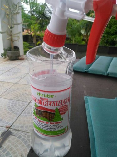

Looking for a water based termite treatment, do you guys know of any.
Hyperion
Posts: 1317
Postby Hyperion » October 19th, 2019, 4:23 pm
Ryan197912 wrote:Looking for a water based termite treatment, do you guys know of any.
Bhagwansingh's Golden Grove has a liquid based termite treatment, not sure if it's water or petrochemical

Most hardwares have a non flammable termite treatment but the scent is horrible. Can't remember name.

Both this today at Bhagwansingh's. It is very toxic.cost $48

Got this at Peaked on sale for $182

Do a test piece first to make sure the paint can still bond on top of the treatment...
jl6106 wrote:Both this today at Bhagwansingh's. It is very toxic.cost $48
