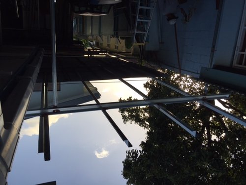

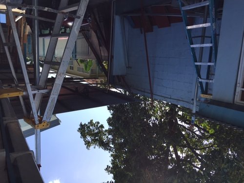

Varma not delivering small quantities so I went down and pickup with my van,
glad I did, very pleasant staff there
me and another guy framed up this in a few hours this afternoon, knowing how to weld is a god send

Postby rspann » February 9th, 2017, 8:19 pm
Why you build the house upside down bro?

Postby pugboy » February 9th, 2017, 8:35 pm
iPhone does mess up pics
