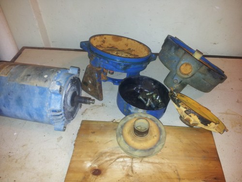

anybody here ever remove the impeller on a gould j5s ?
I took off the main body however there doesn't seem to be a nut inside the impeller onto the shaft
to put a socket wrench on.

pugboy wrote:anybody here ever remove the impeller on a gould j5s ?
You have to hold the impeller itself.

got the goulds impeller off easily, whole thing unscrews as indicated.

Postby pugboy » November 22nd, 2013, 6:41 pm
took apart two Goulds J5S today to change shaft seals.
First one was easy, second give real trouble to get motor shaft out.
Resorted to hitting it with a hammer monkey mechanic style.
Ended up damaging a few of the threads on the end of it.
Had to cut them off with angle grinder, all is well now.
If I had to do it again I would put a piece of metal angle/bar across two bolt holes and use bolts to press the metal bar against the shaft to press it out.
Other than changing the motor bearing I am almost a goulds expert.

Fellas pentax pump only about a yr old is leaking between where the pump two halves is bolted together. Its the casing where the impellar is located, theres a metal shaft that is spitting out water everytime the pump is engaged.
Have any idea what part needs changing, should just be a rubber/seal right?
Dont know since when pentax get like this, last pentax i had last bout 20 yrs and only thing i ever change was tank ever so often
Posts: 29386
Re: Which residential water pump to buy?
Postby pugboy » December 2nd, 2015, 7:45 am
shaft seal about $50 for the part or so
it will require a full takedown to get it off
unscrew end cover, remove fan, shaft nut
unscrew impeller
undo main bolts holding halves together
then take apart and pull out shaft seal
regrease and remount
if only a year old should not be caked up with rust and wasa deposits
