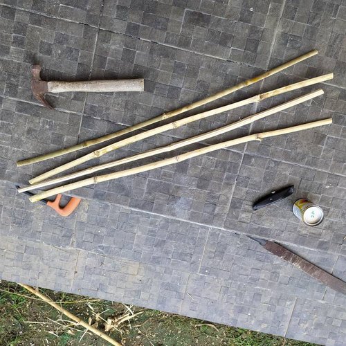

Postby timelapse » April 6th, 2021, 2:00 pm

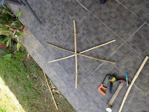

4 pieces of bamboo 38" each.should work for now, but I have extra in case.

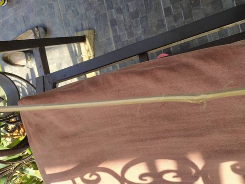

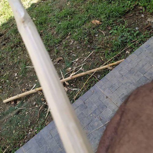

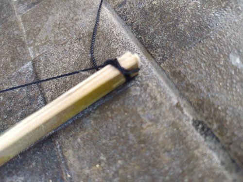

Postby timelapse » April 6th, 2021, 2:02 pm
First pic shows the semi circle on the underside of the bamboo.These can cause nasty cuts , so I cleaned them off with a utility second pic is with it cleaned off somewhat.If kids flying it, sand it smooth

Postby timelapse » April 6th, 2021, 2:26 pm
Mark the middles of them and take 4 inches off one piece.This piece will be the horizontal piece.

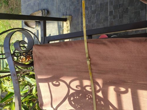

Postby timelapse » April 6th, 2021, 2:31 pm
I wasn't going to make the long nose part , but I study all the tuners that would be following the tutorial and want to make it properly.Will need another flat piece of bamboo,how to measure for it coming up.
Posts: 8810
Re: HOW TO BUILD A KITE

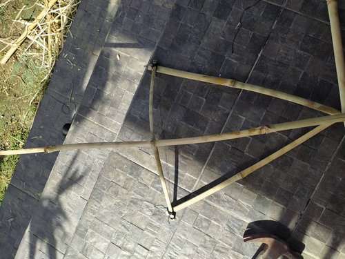

Postby timelapse » April 6th, 2021, 2:51 pm
I started at a joint and cut 9 inches in either direction.So total length 18 inches.I also shaved it flatter because it has to be bent
Posts: 8810

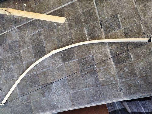

Postby timelapse » April 6th, 2021, 2:59 pm
Make a bow with this using your strong thread.The center of mine is roughly 3 inches.Tie it securely.I cut notches to make it easier.

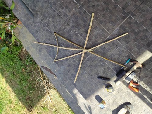

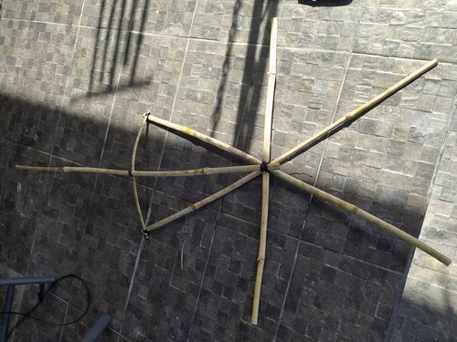

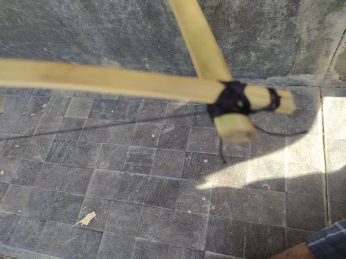

Postby timelapse » April 6th, 2021, 3:09 pm
At this point you need another piece 38" long Also a hammer and a 2 1/2 inch headless nail.Take my dotish advice, this nail will make it a whole lot easier.
Posts: 8810
Postby timelapse » April 6th, 2021, 3:12 pm
A mock up ..Line up your centers and send the nail through.Do not bend the nail.It will be coming back out.
Posts: 8810
Postby timelapse » April 6th, 2021, 3:18 pm
Scratch that.Leave the nail in if the bamboo start splitting.

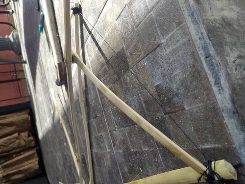

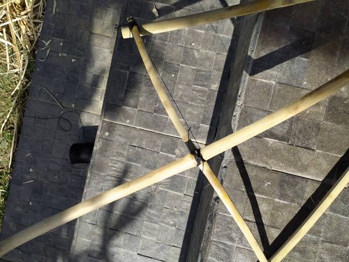

Postby timelapse » April 6th, 2021, 3:23 pm
Tie your bow on the two longer pieces like in the picture.
Posts: 8810
Postby timelapse » April 6th, 2021, 3:27 pm
Supposed to look like this now
Posts: 8810

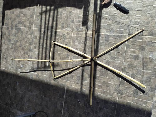

Postby timelapse » April 6th, 2021, 3:36 pm
Tie off the center of the bow and the center of the kite.
Posts: 8810
Postby timelapse » April 6th, 2021, 3:45 pm

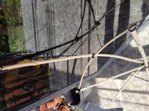

Tie and secure the thread around the perimeter of the frame.Twice like me if you want to make flappers/zingers/ ole noise in the sky
Posts: 8810

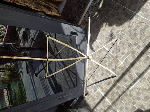

Postby timelapse » April 6th, 2021, 4:09 pm
I usually make it without the nose , but here we go.Make another bow with the nose piece .tie the other end in the middle of the kite.You can tie the perimeter threads as well.
Posts: 8810
Postby timelapse » April 6th, 2021, 4:10 pm
Frame done

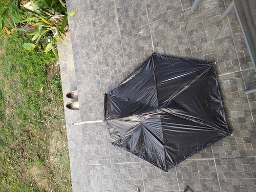

I cut a medium garbage bag to paper it with.Not rocket science here.Apply contact cement then stick down plastic.Start from the center , work your way outward.
Posts: 8810
Postby timelapse » April 6th, 2021, 5:01 pm
Double over the ends when you reach the perimeter strings and stick the plastic to itself.What I forgot, is Dunlop contact cement I am using.Evo stik is too wet.The exposed string is the second set I run for zingers.Leave it to dry overnight.Now I have to acquire some tail cloth.More to follow soon.
Posts: 8810
Postby timelapse » April 6th, 2021, 5:13 pm
Sorry about the sloppy quality, theres an annoying small man in the road that keeps annoying me so I have to be hiding and making it.Do not cut off your loose edges until that glue has cured overnight.
