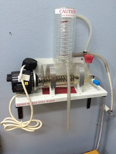

so i diassembled the entire water loop flushed everything took the block apart and found black slimy stuff in the microchannels i cleaned it with a tooth brush and refilled the loop.
its now running at 73 max on prime 95 4.25ghz 1.25v

Postby ismithx » April 15th, 2015, 8:45 pm
are you using distilled water? impure water can cause that

Postby Chiney » April 16th, 2015, 8:30 am
ismithx wrote:are you using distilled water? impure water can cause that
while this is true, it would work until that happens...so yeah..dont use pipe water..lol

Postby jm3 » April 16th, 2015, 8:30 am
It was prefilled by swiftech it had been used for a day. I'm gonna send Swiftech and email. I refilled it with distilled water luckily I make my own here at work we use it to service Micah aircraft batteries lol

Postby Chiney » April 16th, 2015, 8:32 am
blue waters is just as fine bro.. i have that in a loop for over 1 yr now no issues.. temps consistent from day one..
but yeah, not good on swiftech's part.. also, i would put it up on forums with pics so others can know about it before they loose their hard earned bought parts.
