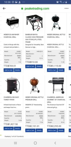

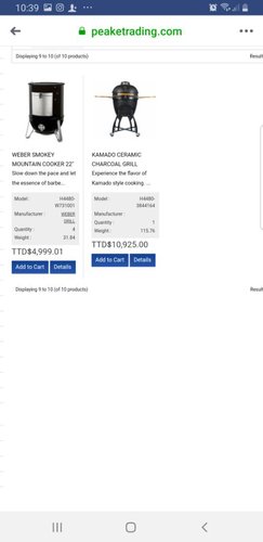

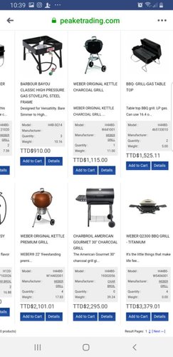

Postby Chimera » August 26th, 2019, 10:40 pm
This is from peakes website
