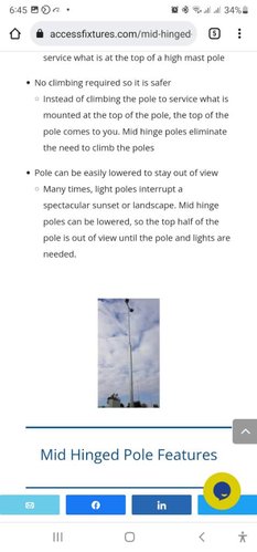

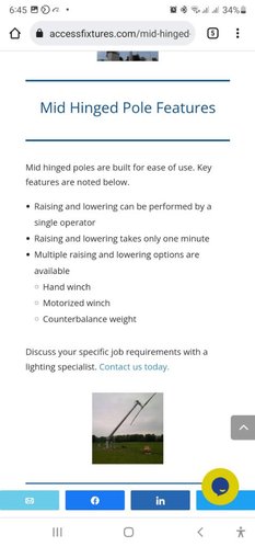

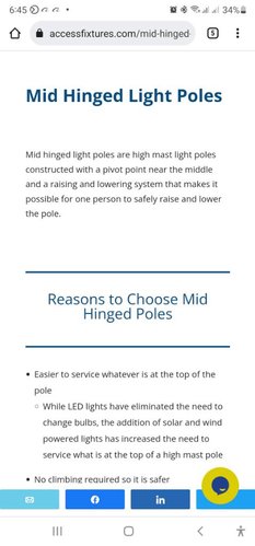

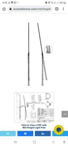

Postby Chimera » February 9th, 2023, 6:47 am
Does anywhere sell this locally or does it have to be fabricated by a welder

Postby matix » February 10th, 2023, 8:55 am
Phone Surgeon wrote:Does anywhere sell this locally or does it have to be fabricated by a welder
Could make that
