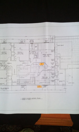

I'd try and give you a break down of the house...essentially its a 4 BDRM..downstairs we have a kitchen, living room, dining room, washroom, guest room, entertainment area and well garage more or less built inside the house
..id try and throw up some pics of the draft

Pics giving lil trouble ..I'm guesstimating 1.3 to build this house...
