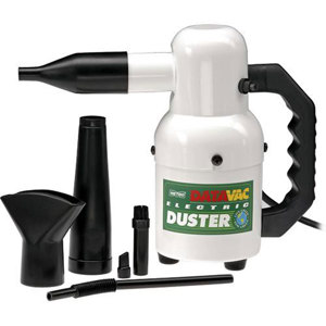

nt sure if posted already but
for anyone using canned air on a regular i recommend you get this
http://www.amazon.com/Metro-Vacuum-ED50 ... ds=datavac
very powerful blower this thing can literally blow a laptop off a table
you can clean a desktop completely in about 10 seconds with it
hustla_ambition101
Posts: 8093
Location: waiting....
Postby hustla_ambition101 » April 17th, 2014, 5:59 am
^^^Bought one of those, too noisy and blowing a set of blasted hot air
Chiney
Posts: 4675
Location: Maracas,St.Joseph
Postby Chiney » April 17th, 2014, 8:21 am
hustla_ambition101 wrote:^^^Bought one of those, too noisy and blowing a set of blasted hot air
noise yes.. hot air. not sure about that.
we use this in the office and it is the best investment we have made in a long shot. sometimes we have over 15 computer a day coming in from offices and we got to clean them out before we even start working out it. works like a charm!
GG whoever came up with the idea!
Spitfir3
Posts: 3654
Postby Spitfir3 » April 17th, 2014, 10:57 am
agreed it is pretty noisy probably about the same noise level as your standard vacuum
never had a hot air problem doh but its better than a vacuum in terms of cleaning by a mile
Cross Blood
Posts: 365
Postby Cross Blood » April 17th, 2014, 11:16 am
Spitfir3 wrote:agreed it is pretty noisy probably about the same noise level as your standard vacuum
Never use a vacuum to clean your PC.
