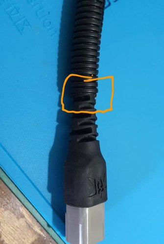

Postby *KRONIK* » February 16th, 2022, 8:39 am
Guys
Whats a good tape to attach split loom to a rubber strain relief?
I wanna add a extra layer of pretection to some lights, but they came pre-wired with deutsch connectors, so i cant put any heat shrink as the connector is too large and the other end is even smaller.
I dont wanna use regular electrical tape as that gonna get sticky and turn to goo in a few weeks.
I have tesa tape, but i feel thats the wrong application for that.
Any recommendations?

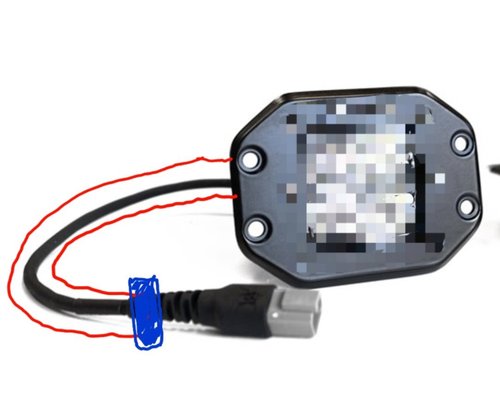

Posts: 9319
Postby *KRONIK* » February 16th, 2022, 10:33 am
Red is the split loom
Blue is the area i want to secure the loom to the connector
Posts: 28735
Postby Duane 3NE 2NR » February 16th, 2022, 10:56 am
The part marked in blue seems sealed already - if you want to protect the deutsch connector then use a large heat shrink tube.
I've used a balloon and rubber band or tiestrap to insulate connectors for outdoor lights already - worked pretty well. I got the idea from an old RC car that came with a balloon in the box to protect the radio receiver from getting wet. The kit referred to it as a "rubber bag".
Posts: 9319
Postby *KRONIK* » February 16th, 2022, 11:19 am
Duane 3NE 2NR wrote:The part marked in blue seems sealed already - if you want to protect the deutsch connector then use a large heat shrink tube.
Its to protect the wire from the lamp to the connector
I'm not worried about the deustch connector as thats very solid and waterproof
But the loom needs be secured to at least one end of the wire

Postby Chimera » February 16th, 2022, 12:38 pm
why large heat shrink wouldnt work?
Posts: 9319
Postby *KRONIK* » February 16th, 2022, 2:42 pm
Phone Surgeon wrote:why large heat shrink wouldnt work?
I dont have a size large enough to fit over the deutsch
Posts: 28735
Postby Duane 3NE 2NR » February 16th, 2022, 3:21 pm
Can you take apart the deutsch connectors and put shrink tube and then put it back together? Deutsch connectors are made to be serviceable.

Posts: 9319
Postby *KRONIK* » February 17th, 2022, 1:55 am
https://youtu.be/y36HyvJAB3k
No
These are made and moulded on to the harness

Posts: 9319
Postby *KRONIK* » February 17th, 2022, 7:39 am
Ok
Lewwe start again
Its to secure the loom to the rubber end of the connector in the area where they meet in the orange box.
I hope this clears that up.
Also, its just an option besides regular electrical tape i need. Electrical tape gets sticky and i trying to avoid that mess
Posts: 8788
Postby timelapse » February 17th, 2022, 8:40 am
*KRONIK* wrote:
Ok
Lewwe start again
Shrink seal

Posts: 9319
Postby *KRONIK* » February 17th, 2022, 8:55 am
X_Factor wrote:
*KRONIK* wrote:20220217_073341.jpg
Ok
Lewwe start again
heat shrink, even better if you can order the type with the adhesive lining on the inside
I have this
But the largest size still too small to go over the rubber
Posts: 20002

Postby adnj » February 17th, 2022, 9:20 am
*KRONIK* wrote:
Ok
Lewwe start again
I have this
I suggest that you try 3M Temflex vinyl tape. It is not expensive, either. You should be able to find that at Modern Electric. It has a 200°F working temperature so you shouldn't see adhesive flow. Otherwise use Polyken vinyl, if you can find it. It has a higher working temperature.
If you go to Modern, you can ask for 1-1/2 inch or 2 inch 3:1 heat shrink. Those should work, also. You aren't weather-protecting so dual-wall heat shrink won't do anything except look sloppy.
