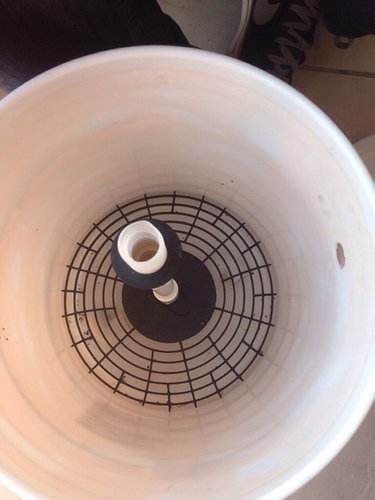

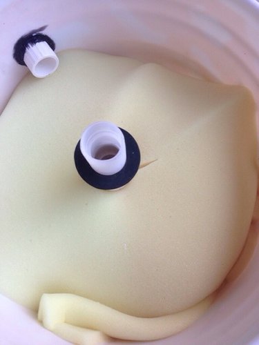

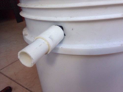

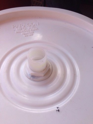

Filter in the making. Jus to get some Dacron and sponge.

I wont lie, very impressive.

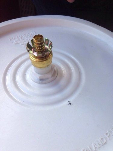

Very well done on the filter , be sure to share some details
Personal preference on the hose ends or beginning. I used these ends in the past and for filter purposes it worked for some time until it began to rust . I have recently switched over to the plastic hose ends .

certified_dealer wrote:Filter in the making. Jus to get some Dacron and sponge.
Impressive, but just from my personal experience, depending on your pump capacity (GPH) that 3/4" outlet you have at the top WILL be too small to let the water out (I actually thought that size in = size out, but boy was I wrong!!).
I did something similar, but ended up having to change the outlet size to 1 1/2" piping instead, because the bucket kept on overflowing. I was using a 840gph Rio submersible pump.
Lemme know how it goes!!

Postby certified_dealer » March 19th, 2014, 6:03 pm
Well the pump is 500 GPH. I will change the hose end to plastic, thanks everyone.

Postby certified_dealer » March 19th, 2014, 6:08 pm

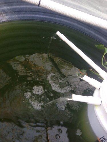

For the outlet I might modify it to 2 or 3 outlets. Same size

Postby Kasey » March 19th, 2014, 10:09 pm
^^Yep u will have to add outlets or change to a larger outlet. Had the same prob myself.

Postby certified_dealer » March 20th, 2014, 8:02 am

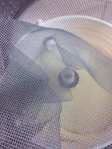

Well stuff the filter with sponge and mosquito netting.

Postby cornfused » March 20th, 2014, 1:45 pm
Not sure about the size and filtration of that foam . I would use the black foam with larger spaces . Be sure and don't starve the pump.

Postby certified_dealer » March 20th, 2014, 3:24 pm
I'll be changing the sponge to Dacron jus didn't get change to go get it.

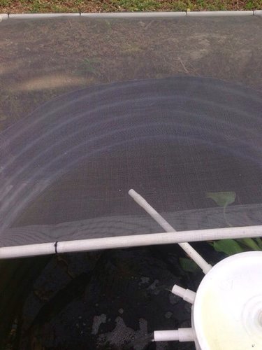

Postby certified_dealer » March 20th, 2014, 5:23 pm
Okay. Nice. Will check dem.
With the remaining PVC and netting made me a cover.
