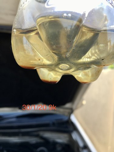

i bleed my hilux filter canister this morning after a padna get a bad fillup in st augustine.
pretty clean for 9000km
99% fillup by flour mills and other times by new station el socorro

I am convinced the high sulphur content is not the problem.
Both power service diesel kleen and redline 85 plus fuel additives claim to reduce wear in vehicle using ULSD to levels similar to high sulphur fuels. That tells me that the high sulphur content offers decent wear protection in the fuel system; at the cost of poor emissions.
Our diesel has poor combustion characteristics (lower cetane than what is required from most diesel vehicles on the market)
Our diesel is seriously contaminated; dirt, water, algae etc.
I also have a theory that the more sophisticated diesel engines (read Euro diesels with higher horsepower and quieter engines) might see more problems simply because of the volume of fuel injected and the number of injection events per cycle (suck, squeeze, bang, blow). Simpler systems care less about noise and emissions... But Euro diesels are pretty quiet and they have been for years (well ...before the injectors call it a day).
Sulphur is just easier to blame so everyone says it. When ULSD gets here, I feel there will be even more diesel vehicles in garages awaiting injectors and pump replacement (unless something is added to the fuel to help its lubricating properties).
Not sure what type of ULSD AM is selling though.
