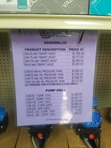

In the market for a pump myself.. Went to water source ltd and this is their price list for the pentax.. Still up in the air about whether to get a goulds or pentax
Last price i got was from ramlagans in balmain for a 1/2hp goulds with pressure tank for $2990 and the 3/4 with pressure tank $4257.90.
Posts: 18408
Re: Water pump
Postby Dave » June 5th, 2020, 2:31 pm
Prices are not bad. Deal breaker when looking at a Could unit.
I was watching a Wayne unit from the US but shipping and minor parts may be an issue.

That goulds 1/2hp price real good. Several other places selling it between 3400-3800. Id buy a goulds though. Bulletproof!!!!! Things to change in between: capacitor, pressure switch and tank
