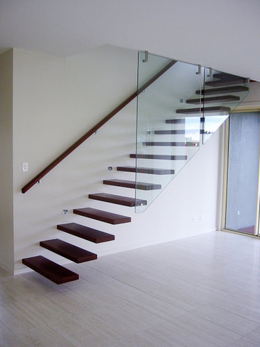

Where in Trinidad can you get cantilever stairs made..

stang wrote:Where in Trinidad can you get cantilever stairs made..
Once you have engineering drawings for what you want, any contractor worth his salt can construct the stairs.
You did not mention what type of material you want the stairs made from, for example, timber, reinforced concrete or structural steel.

Postby stang » April 19th, 2016, 9:52 am
Am interested in the following design.
