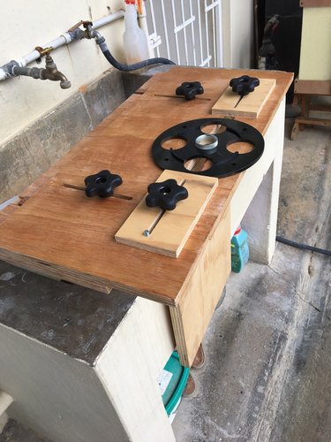

Postby pugboy » November 3rd, 2019, 12:44 pm
Almost finished router mortising jig
Sturdy and pretty much square.
Just need to do the clamping setup on vertical board below.

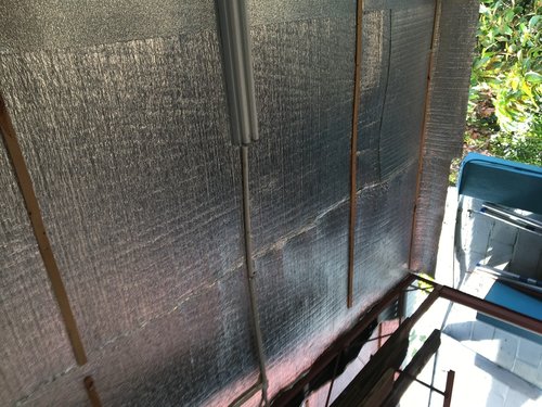

The proper heat barrier rolls have the soft, cushioned backing. When I did a large front covering I used it, and even on baking hot days, you cannot feel any heat radiating from the sheeting.
Postby Rovin » November 7th, 2019, 10:21 am
hmmm allyuh have meh thinking now , whats d cost of these sheets & d dimensions of it ? ....
Posts: 29357
Postby pugboy » November 7th, 2019, 10:38 am
Roof systems have a good quality one with thick foam about $1000 per roll, 4ft wide
Roll does 500sq ft
There are other brands out there but thinner and flimsy.
