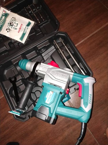

Postby X_Factor » October 3rd, 2019, 8:20 pm
Bought it for 750.00
Comes with 3 drill bits and 2 chipping bits and a tube of oil grease
Feels fairly sturdy
Will put it to work weekend
Posts: 29332
Postby pugboy » October 3rd, 2019, 8:53 pm
Give it a good workout
From its design it appears to be pneumatic hammer type like a hilti combihammer.
